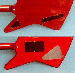

Back view of Standard and Blitz
Shown are the back views of the body of an early Standard (top) and a Blitz guitar (bottom). Note that the Standard has a sculpted heel, two control cavities and an oval backplate (although these are triangular on later examples). The Blitz lacks the sculpted neck-body joint, has a triangular back-plate, only one control cavity and a cover for the trem. springs.

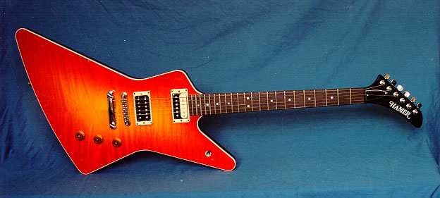

1995 Standard Reissue
A Reissue Standard (1995) in "59 Burst" - dot inlays.
