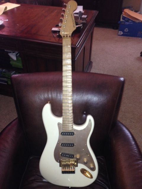

Drendino Posted February 12, 2014 Posted February 12, 2014 After reading an article on the SD forum about the pros and cons of scalloped fret boards, I've decided I'd like to try one. I've got a '76 Strat that is already super-ized with a SD Distortion, a Floyd, and few other mods. Was considering pulling the neck off and putting a custom order Warmoth on. The Warmoth would be unfinished birdseye maple w/maple board, scalloped, stainless frets, routed with a shelf for the Floyd nut, and of course a reversed CBS era head stock. This would be vast improvement on the stock neck which is maple, rosewood and has the Kahler fingertite lock behind the nut. Best of all? It would be totally reversible in the event I grow tired of scalloped boards. Anyone have experience with either scalloped boards or with Warmoth products? Here is my 48th St Custom Guitar with scalloped board that I had made in the 80s. It has an original Floyd Rose. All of this is in IMHO and it all depends on what you are trying to do musically. However, I feel that you give up way more than you gain. Intonation while chording is a problem. While I never would have admitted it in the 80s, there is nothing quite like the feel of wood under your fingers and I never got used to it. It was one of those things that sounded good in theory.
