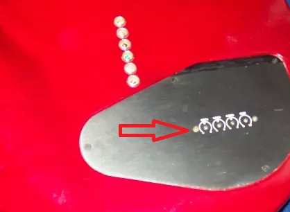

veatch Posted September 22, 2016 Posted September 22, 2016 The EQ board used on the DuoTone, Vintage S, etc. I need one of the two black screws that holds the board to the control cover. Anyone know the size/thread on this? I think it is a 2mm, but not sure of the thread count. Tnx.

HAMERMAN Posted September 23, 2016 Posted September 23, 2016 I has a suspicion that something from USA of that vintage wouldn't be metric so I just checked an EQ board I have in my parts bin and the screw thread is 2-56 (US).
veatch Posted September 23, 2016 Author Posted September 23, 2016 Woot! Woot! Now we're talking... Thanks.
