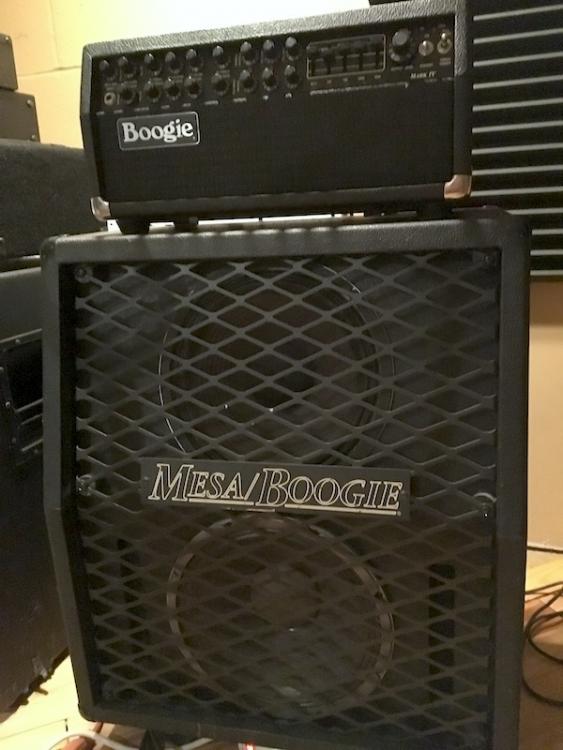

My latest experiment with my Boogie vertical widebody closed-back 2x12 is worth consideration. I have an old and worn-in nicely 70-watt Celestion from 1982 that I love. I decided to pair it with a basically brand new one from another amp in the shop  - harvested speaker was one year old and nicely broken in. The old one (which we'd assume is looser and "tired" and is definitely warmer to my ear) is in the slant top. The new one - which I'd assume is tighter and brighter because it hasn't been vibrating at excruciating volumes for decades - is in the bigger volume straight bottom. I don't know if it's a grail setup but it's definitely good enough that it ended what was turning in speaker swap ritual every month or so. This is the best speaker pairing for the Mark III I've put together so far.

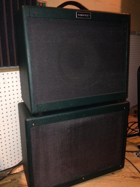

Mating a combo with a closed-back cab has been a longtime mainstay with Mesa/Boogie. Usually a Mark-series combo with an EVM-12L loaded Thiele. The combination of the focused, ported Thiele with the openness of the combo makes for a huge tone. I did almost the same thing with my SamAmp, but it wasn't a Thiele.

I thought I had a pic of the completed setup, but here's my old Mk IV and Thiele cabs.

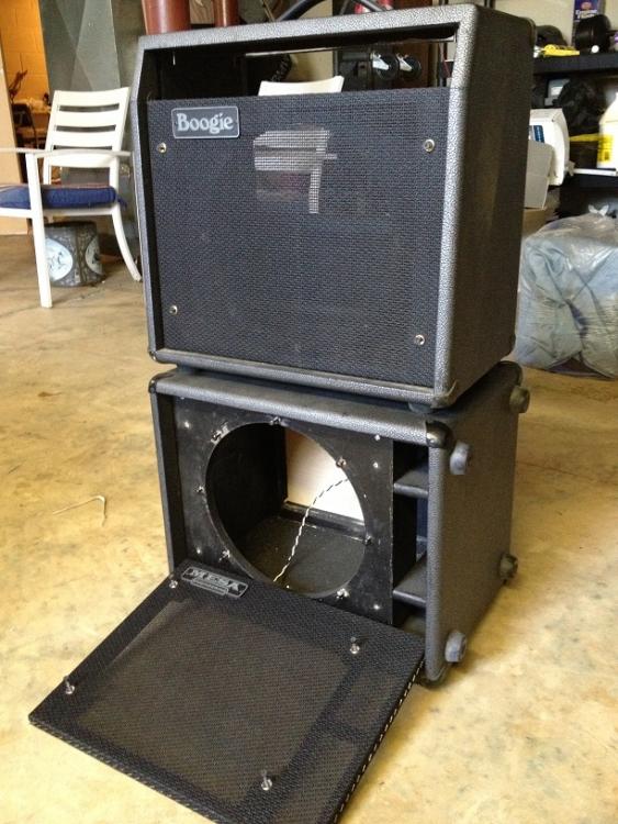

I had a Mesa DC-2 1x12 combo with a standard Mesa 1x12 extension cab...sounded huge.
And a Mesa Maverick 1x12 combo with a Mesa EVM12L Thiele cabinet...sounded even better.View attachment 17581

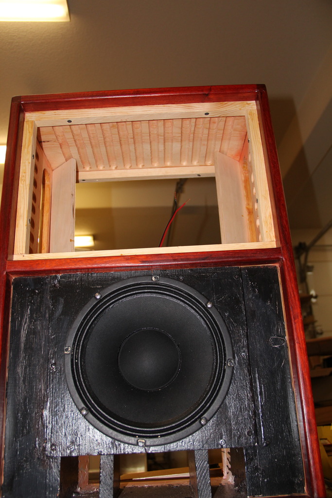

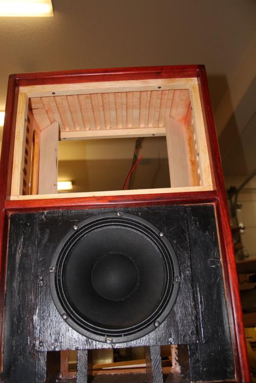

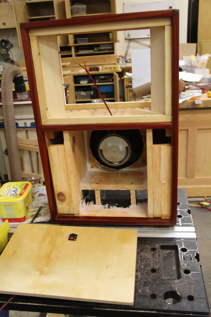

An example of a slimmed down "combination" cabinet using 10s in a Forte/Thiele configuration. (Hoping the pix work in this other format for sharing).
I have this one, totally closed back and no internal separation board between the slant and the straight, like an old Marshall 4x12. Smaller, yes. Lighter, I guess, I know it's lighter than Boogie's 4x12s.

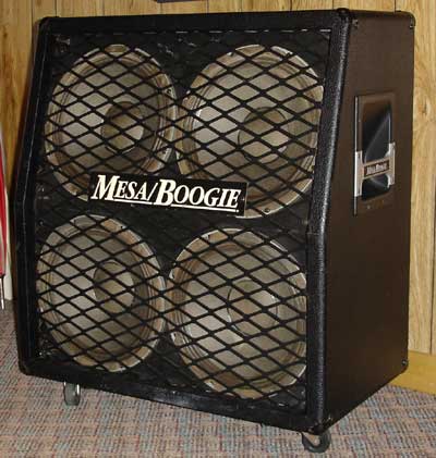

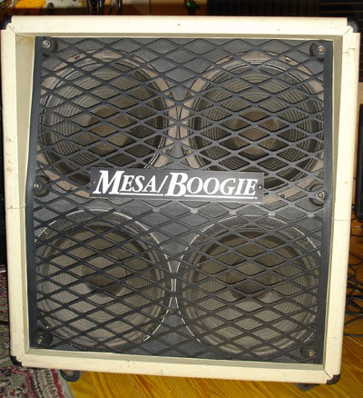

As long as we're bringing up Mesa Halfbacks, I found pics last night of a couple of my old 4x12 cabs. The first one is cream and had 2x MC-90s and 2x 150w MS-12 speakers. The MS-12 was Mesa/Boogie's stock speaker in a lot of combos and cabs. The EVM-12L was the upgrade, but the MS-12 is a great speaker in its own right. I sold it on CL, and when the kid came over to pick it up, I was playing through it to show him it worked, and I was thinking the whole time how stupid I was for selling it.
