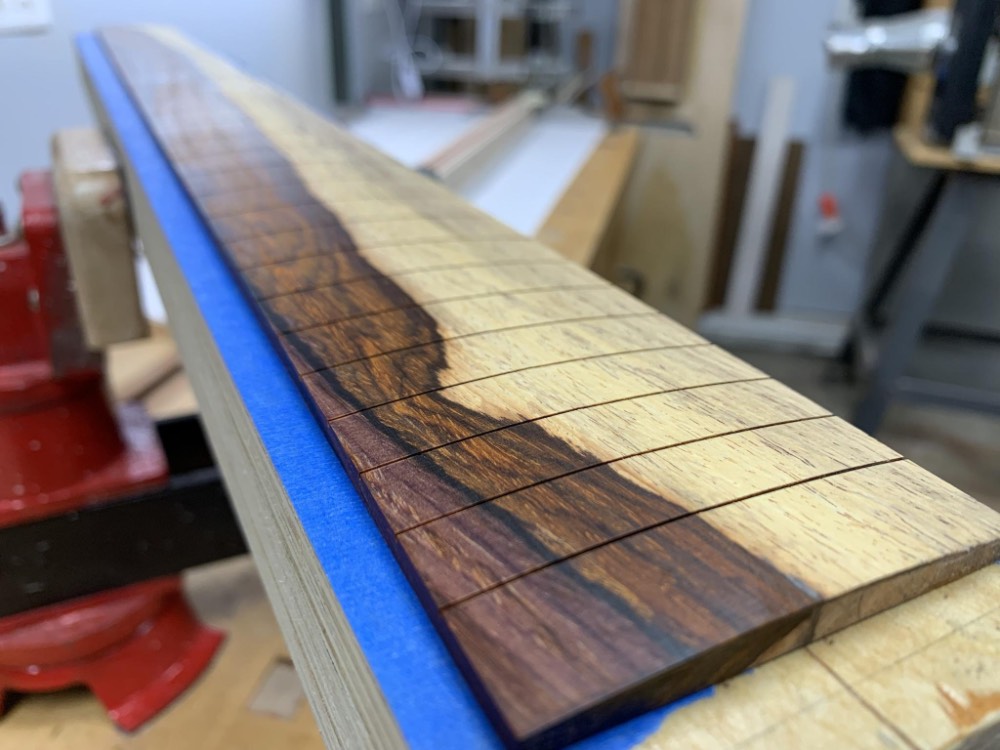

Roughly tapered, slotted and radiused the heart and sap cocobolo fretboard. That's gonna look cool! :D
