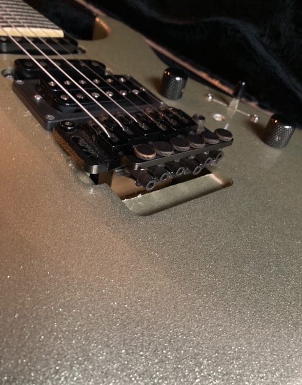

Ok, gents, I’ve been thinking about this for a while and it’s time. I’m going to block the Floyd on my Charvel for dive only. Given the route, wondering if I should use wood in the cavity or the stack of pennies method (5 pennies, I measured...)
Or, are there any other methods y’all have used that work best, offer the optimal vibrational transfer for tonal maximization and preserving the acoustic voice....  🧐

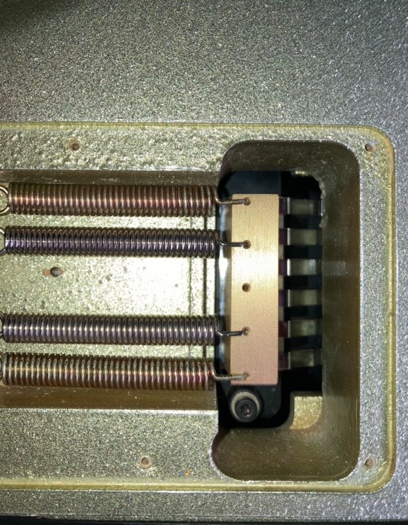

Drop a piece of wood right there with proper thickness so that your trem rest on top keeping your current Action height while Maximising tone and sustain
Another way is to cut a piece of wood and affix it to the BIG block (neck-side) using double-sided sticky tape: I've done this on a couple of PRS's recently where the client wanted 'dive only' tremolo's but also wanted the option to reverse the mod...
I used a block of walnut (because it was handy) and a drop of thick CA (superglue) to block one of mine. The CA holds it secure, but a quick tap will knock it loose easily if you want to go back.
This is the way to do it.  Super easy and done/undone in a minute or two.
