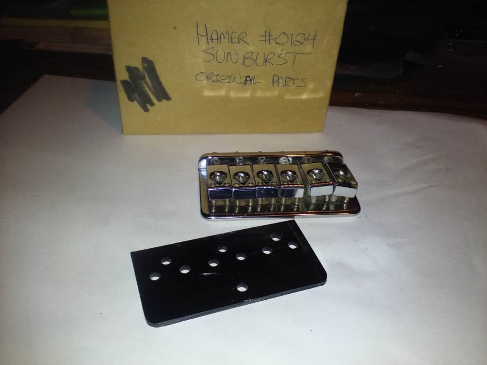

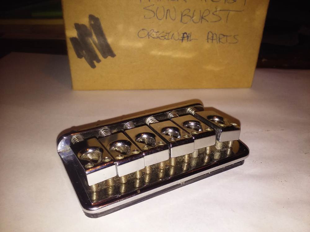

I've been meaning to post this but wanted to do a hole comparison with a tele bridge. Still haven't done that but here's some pics of the bridge off of, I think, 7 0124.
