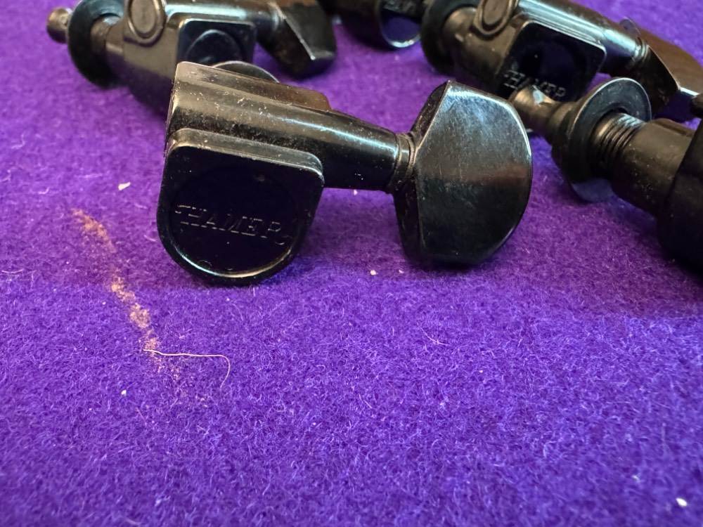

Got this tuner damaged during delivery.
Anyone can sell me a replacement tuner?

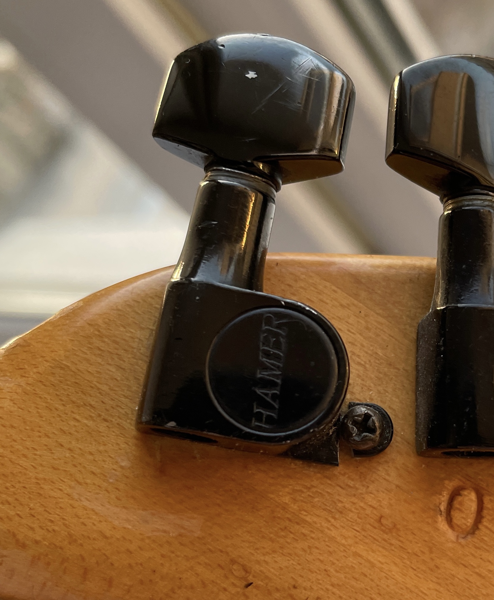

I will asume your guitar is USA  made cause a can see a cero stamped
, This kind of tuners are originaly schaller ( the masters tell me if im wrong please ) , so if u cant find a hamer logo replacement , a good option can be buy 6 schaller tuners may be? Cherrs
Thanks! Yes, these were made by Schaller. I’ve already found and ordered single schaller tuner on eBay (used). I’ll replace the part with Hamer logo, so in the end there should be no difference at all
Ooh! yes! the button with the Hamer logo should pop right into the Schaller. Have you watched any of the youtube vids about removing that button using a bit of heat and a magnet?
Yes I’ve seen them, but I’ll probably just take it to luthier, don’t want to mess anything up
I did that on an Ibanez bass tuner (the only crappy tuner Gotoh made), it was almost magical: I heated it with a cigarette lighter iirc, placed my biggest magnet on it and the cap popped right out to the magnet, I think I just used a guitar amp speaker for the magnet
