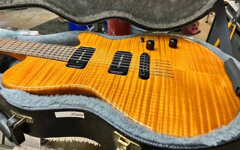

Drop the tension on the strings and polish with Dunlop 65.

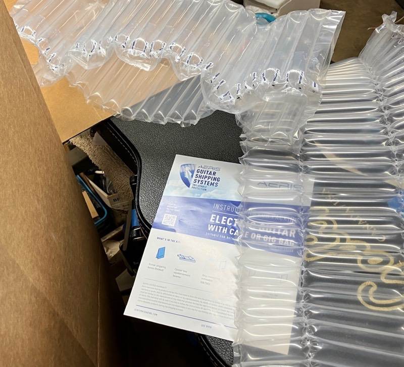

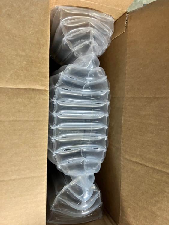

This is how the cap ballon covers the top of the case

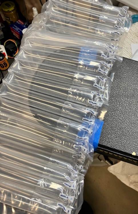

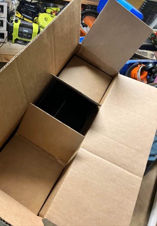

The gaping maw that is the bottom wrap ballon

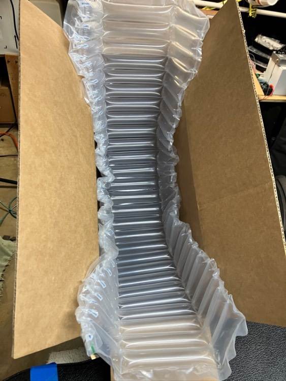

The stabilizing cardboard insert that “collars” the case
Le top ballon en place

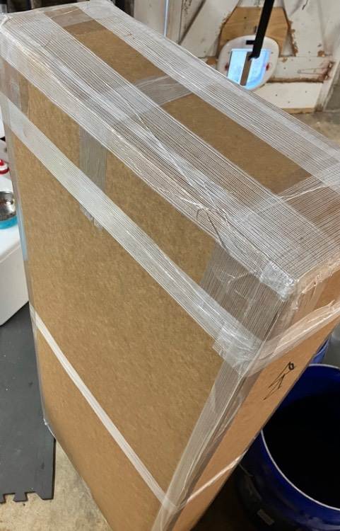

Tape that bitch. I use the heavy duty stuff as a wearing surface at the corners

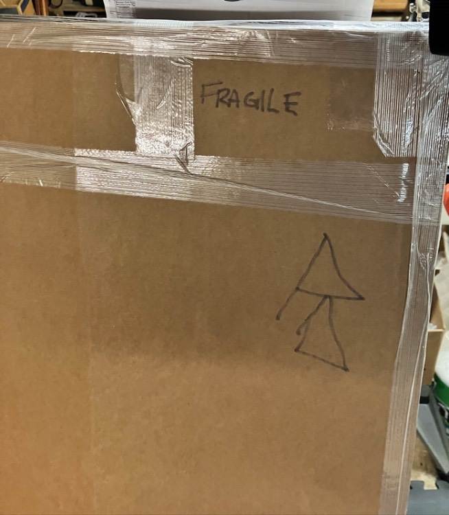

Label nicely 46” x 7” x 19” around 24 lbs for an electric. Cube minimum weight will be more like 33 lbs
