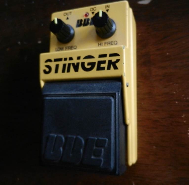

I bought this used quite a while ago, messing around with it lately, it came with just 2 screws holding the back on, which don't seem to fit well.
I brought it over to the local McLendon's, where they do have a pretty good fastener selection, but nothing that fits this as far as I can tell. It seems to be about a size 4 but with much coarser pitch than 40.  Boss and Ibanez don't fit either.
Suggestions?  The back photo doesn't really tell you anything, but I took one.

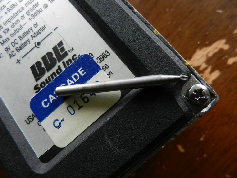

tips for removing a questionable quality hardware store screw that broke off in there? There's not quite enough sticking out to get a good bite with the needle nose vice grips. And of course it's pretty tight because I was trying to make new threads with it...
Take a slightly smaller drill bit and drill about an 1/8" deep pocket in the broke off screw. Create a slot (I usually take a crappy old screwdriver and smack it with a hammer). If you're lucky, the smack with the hammer will loosen it up a little, and the slot should allow you to unscrew it.
If that don't work, drill all the way thru the screw. And get a bigger hammer.
All is well, without too much time or having to buy any new tools:
After giving up trying to back the broken screw out, I used my dremel with the bit in the photo to flatten out and make a concave in the busted off screw, - so that a drill bit would stay in the screw, and not wander into the pedal. I put some kitchen 'press&seal' plastic over the back of the pedal to keep metal bits out.
Started with a very small drill, and after 'stepping up' twice, the screw threads came out with a 7/64 bit.

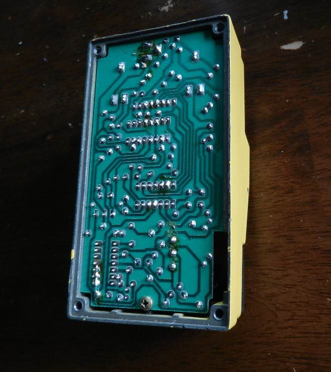

  Threaded with a 3mm .50 pitch tap (because I already have that one, in a cheap Harbor Freight tap/die set), and 4 x $.50 at the hardware store I've got screws that go in and out, and hold the back on.
