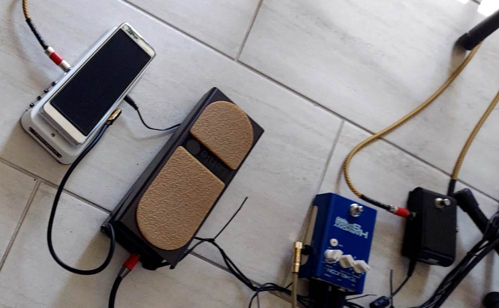

Dutchman Posted November 16, 2024 Posted November 16, 2024 I bought this a couple of weeks ago and initially was going to not use it as it would not play with my Xotic Wah. It would start screaming the dieing speaker scream right at 8k. No matter how I put things in the chain to my board it screamed. So I took the Wah out and beautiful perfect volume swells! Just sounded great! I got in touch with Jon in Germany and he suggested all of the things I had already tried. But he was trying to figure it out too so kudos for that! I went 100% discrete power supply for both units and poof no more 8k squeal!!! I also put the Wah ahead of the Lehle pedal. I think there was some buffering causing the squeeling but not 100% sure. I am happy to report that the Lehle Volume pedal is the best Volume pedal I have ever used. Dialed back there is no change in tone. This is huge!! So when I switch guitars I just adjust the pedal to where I need to be. It was a struggle worth the time and effort and I gotta say the Lehle is da bomb!!!
