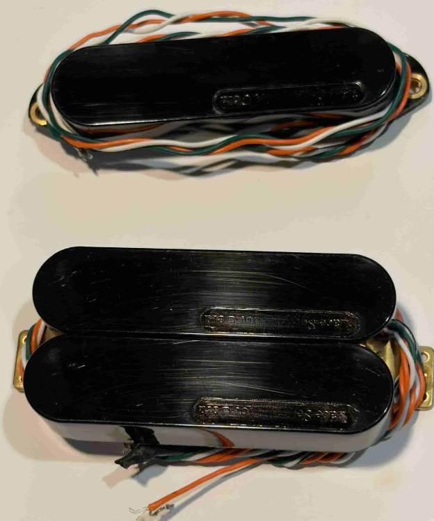

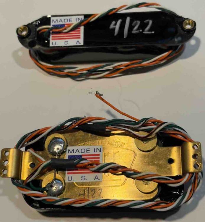

2 Pickups  - 1 Humbucker, 1 Single Coil.    Came in a '98 Phantom.  Markings were covered over with sharpie or something, so the colors of them aren't visible.  I tried to get info about them from Lace, but never heard back.

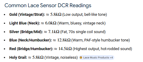

Found this that might be helpful (if you have a multimeter):
They're supposed to be incredibly consistent by all accounts.

OK.  I tested them.
The single reads 6.13, but the humbucker reads 25.99 (?)
I was using the red for the hot and it has green and white with black stripe tied together for the ground.  It also has the red and black and white tied together and covered with heat shrink.
Seems odd, but it worked fine in the guitar before I removed it.
EDIT:  I just noticed the ears of the single coil have been hacked off on one side.  I suppose they were that way in the guitar.  I certainly didn't do that.  You can see on the top of the second photo.
