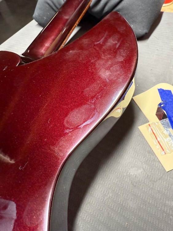

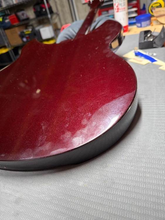

I recently acquired a RIC 75th Anniversary 330.

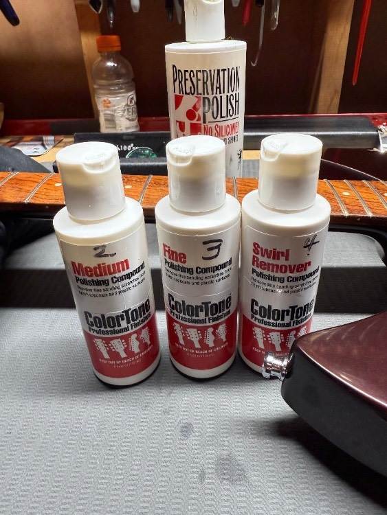

It had some surface scratches that I decided to address using Stew Mac polishing compounds.  I've used these materials many times with excellent results.
I was shocked to see that the RIC finish reacted to the polishing compounds in a very negative way.  Normally the compound is applied with a foam pad attached to a  low speed  battery powered hand drill.  It's spread over the finish, then left to dry for a minute or two.  The material dries to a white powder which is then wiped off with a microfiber cloth.  This process is repeated with sequentially finer grits.
When I attempted this with the 330, the compound did not dry. It remained on the finish as a greasy, sticky film, possibly melting into the finish.  I also noted that there were fingerprints on the back of the guitar resulting from simply touching that area with the compound residue on my fingers.
I researched Rickenbacker finishes and found that there is a lot of speculation and mystery floating around on the RIC forums and that the company says it's a "UV cured Catalysed Poly" .
I've added photos.  Has anyone ever encountered anything similar and, if so, is there a remedy other than stripping and refinishing the guitar?

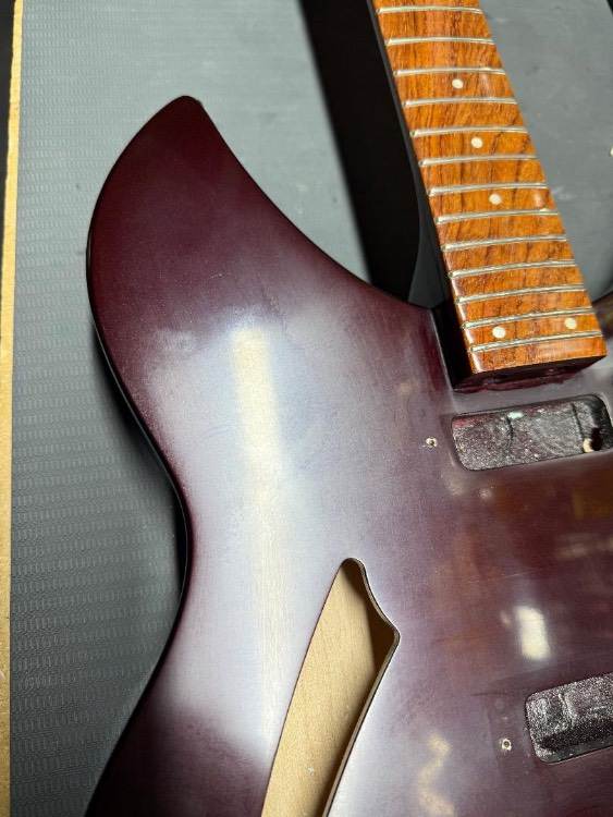

I tested the same materials on a Warmoth Polyurethane finished body and had no adverse effects, so I'm confident that the Stew Mac products are not defective.

After further messing around with the this, I'm becoming convinced that a previous owner applied a thick coat of some kind of wax.  I've tried applying goo gone, naphtha and Mcguires swirl remover to small areas.  Naphtha does nothing, Goo Gone w/citrus seems to cut through to the underlying poly coat, but it's barely effective and moves the cloudy gunk around, rather than dissolving it.  The swirl remover reacts with the (wax?) turning it cloudy.
So, the question now becomes:
How do I remove wax without compromising the underlying poly finish?
Thanks!
