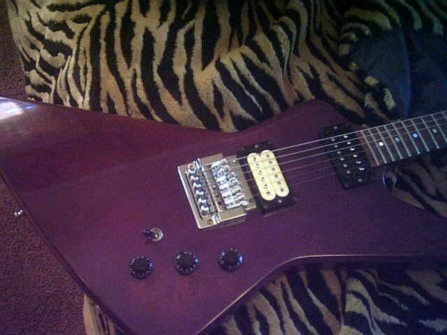

Punkavenger Posted September 15, 2005 Posted September 15, 2005 In the past I've dealt with a music shop in the midwest and I really like the people working there . They know a lot about guitars and helped me pick out the Lindy Fralin P-92's for my SG which I love.When I approached them with the "what pickups for my 82 Blitz" question they asked me if the guitar was "dark, rich, bright, midrangy..." I said "I dunno, it just sounds kinda flat to me"How do you determine which of these things the guitar sounds like?The amp and guitar can be adjusted many ways... Would you set the controls at a certain postion? Play the guitar "unplugged" perhaps?Does the 82 Blitz (with khaler locking tremelo) have a specific or stereotypical sound? Pardon my stupidity but I've only been playing for a couple of years and don't have enough knowledge to be able to say "this guitar sounds dark" etc.Thanks!

Nuclear Wessel Posted September 15, 2005 Posted September 15, 2005 With a mahogany body and neck, and rosewood fretboard, I'd expect it to sound warm and midrangey. Not overly bright but not dull either. But that's just going by the guitar's materials. What you really need to be able to answer that question is what you said you haven't got yet - time to play and get familiar with the sound of a bunch of different guitars. The Blitzes with Kahlers that I've played (2 of them) both sounded hot, crunchy and aggresive. I think that was accentuated by the hot bridge pickups Hamer put in them at the factory. Some guitars do immediately strike you as having no bass or no high end. I've owned a few like that. If your Blitz sounds "kinda flat", what are you looking to hear more of?

Nuclear Wessel Posted September 16, 2005 Posted September 16, 2005 Yeah that bridge pickup is probably a replacement. If it's got hexagonal screw pole pieces then it's a Super Distortion. A popular replacement bridge pickup back in the 80's. Not bad sounding. Heavy, loud, and a little dark but still chunky.If you haven't yet, I'd try adjusting the pickups closer to the strings. That may be part of your problem. If they're adjusted farther from the strings, you'll start to lose tone. The bridge pickup being weaker than the neck pickup sorta makes me wonder. A lot of do it yourself guitar techs in the 80s screwed up the wiring for their pickups when they replaced them. You might want to check to see if the bridge pickup is connected right. The previous owner might have wired the coils in parallel or not even connected one coil by mistake. Instructions for correctly wiring Dimarzio pickups should be on their web site somewhere.A JB/Jazz combo would probably sound great. I think a lot of Curt Cobain's sound was what effects and amps he played through, because there are plenty of players who use the JB at the bridge and sound nothing like Cobain.OTOH, if you're after a heavy but darker tone while still retaining clarity, the Duncan Custom Custom would be my choice for bridge pickup.

Punkavenger Posted September 18, 2005 Author Posted September 18, 2005 Ok...This what I did.Bought the the 59/custom combo and some heavier Ernie Ball strings...Got a a really good price at this cheesy guitar shop in town (they price match with almost anything you can find on the internet)(hate being cheap but I have no choice at this time period)Going to bring everything over to my buddy working at the high price shop and have him install the pups, strings and check everything to make sure its perfect.I should be back in business by tues. night.Sorry, didn't receive your last post in time BTMN, I was out shopping.If I had known you felt so strongly about the SH-14 I would have gone with those.My novice opinion of the whole situation is thatA. Pick ups were too far away from strings causing a big part of the problemB. Strings were much too thinC. The neck pup was probaly fine and possibly even the bridge, but they didn't work well together and since I have no way of knowing what Dimarzios they are, its best to start out with a known factorD. The guitar tech from the midwest (He is actually is really bright, I'm probaly the one that screwed up on that kahler/schaller thing. Too many paint fumes...) that recommended the Lindy Fralins determined that for the sound I was looking for PAF's would be best and essentially thats what I am doing with the 59/custom combo...E. I'm going to also purchase a MXR dyna comp compressor and Maxon overdrive to help me get that sound I'm looking forI'm sure it's going to sound great ... Now I need to practice!speaking of which...Hey! Anyone have any tips (books, tapes, internet sites etc.) they could recommend for a guy thats been playing for a couple of years (hard rock) but still pretty much sucks?Thanks again!

Punkavenger Posted September 20, 2005 Author Posted September 20, 2005 Got the Blitz back already and its beautiful and sounds terrific ...My guitar tech buddy spent 3 hours on it getting everything perfect...Best $80.00 I've ever spent!
