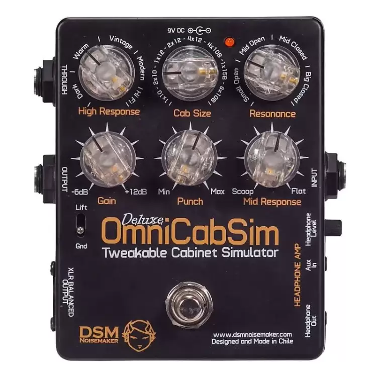

What chu need to do is buy this and put it in the loop for use with the gain channel. That open back does okay with Fenderish, but lacks conviction for Marshallish. The cab sim gives a way to tweak the response. Easy peasy even I can do it, have done it. I sold it with the amp.
Velcro a 9V to it and stick it inside the amp.
https://reverb.com/item/70388847-pedal-pcb-uni-dsm-omni-cab-sim-cabinet-simulator-alchemy-audio-guitar-effects-pedal?utm_source=rev-ios-app&utm_medium=ios-share&utm_campaign=listing&utm_content=7038884

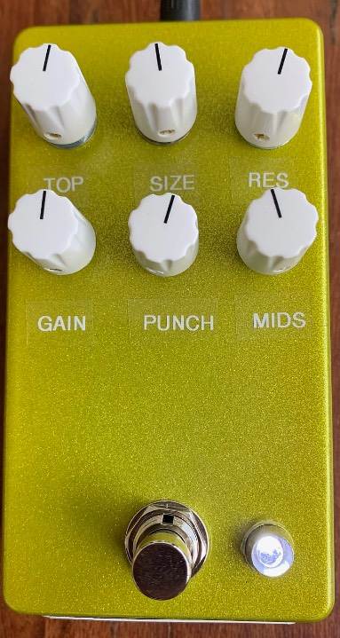

Here’s what the controls amount to in practice.
Annnnd it looks like they can be had on the used market. The clone was taken from a user group contributed by the designer who lives in Chile.
I'm mostly just using it as a monitor, with the di to the house, now with the di from the Flyrig to the house, so I don't actually need to use the footswitch anymore, but it would be nice to get it working correctly.   Those cab sims do look like fun, all by themselves, much more evolved that my old Redbox mkii !
