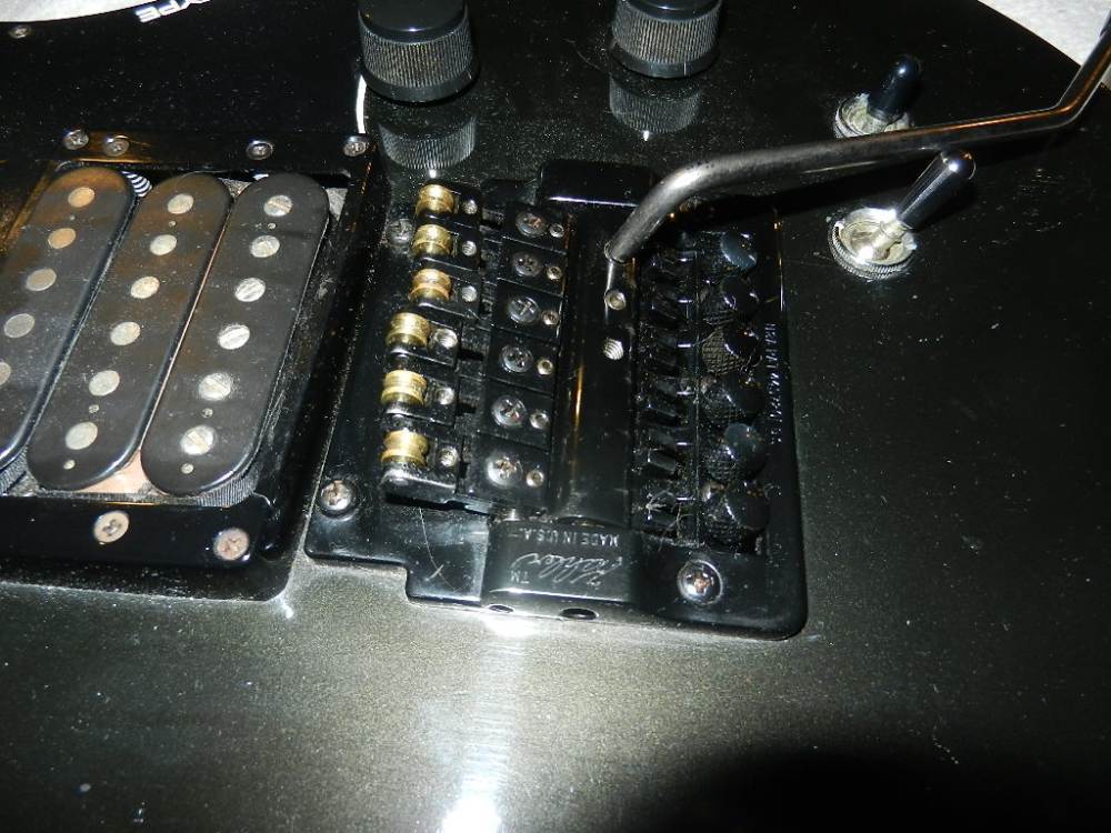

thanks!  mine was WAY overdue for a change, and I don't think I removed all of the strings last time, not knowing what would happen.
  It seems the fine tuner heads limit the travel, which keeps the string ball end holders up to where they can be reloaded.
Lube those rollers! Most issues with Kahlers are sticky/stuck rollers. You should be able to spin them and they continue spinning for a bit. So very free spinning!
Also lube all other contact movement points. I used gun oil, 3m oil works to. Don't leave them dripping with oil just get it in the joints. I would hang my guitar of off the whammy bar like a yoyo on my old Kahler bridge Charvel. Always came back in perfect tune. I also used Stay In Tune (SIT) strings for Kahlers. They're built a little bit more robust!
