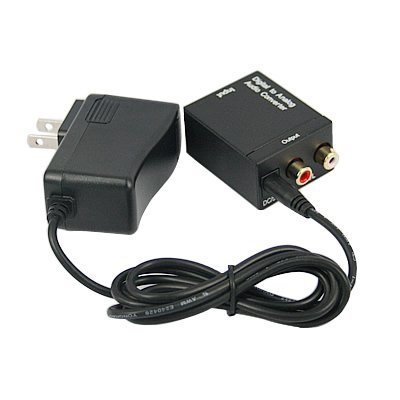

Speaking of cheap DACs, however, we just got one from Amazon (this DAC) for $14.86.
We got our son a 32" flat panel TV for Christmas, but neither the XBox 360 nor the new TV offer analog outputs to plug into his stereo. So we just got this DAC that accepts both Toslink or RCA (coax) S/PDIF digital input and then outputs analog stereo. It just got delivered today and works fine. Make sure you order one with S/PDif input and that comes with an AC power supply. Some are for USB only or have Toslink but no S/PDIF input. And make sure that you configure the source component (e.g., your Blu-ray player) to output PCM digital and not something else like Dolby Digital. On my son's TV, if you configure output for Dolby Digital you just get a clicking noise. Configured for PCM it works great.
