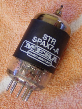

My Mesa did something similar but it was quite loud. It turned out to be V1 or V2, don't remember which. Also one of those tubes may have a rubber ring around it. I don't remember which but the schematics are easy to find online. Mesa tubes are Sovtek but they grade the Power tubes. So I'd buy Mesa / Sovtek power tubes since there is no bias adjustment. As you know you can throw in any preamp tube you want. Just watch for the one with the rubber ring. That one needs to stay in its position IIRC. But you can swap it out with anything 12xx7 to see if it silences your farts and then get a replacement with the ring.

The "special" spax7 has a rubber sleeve on it from the factory. They are supposedly extra low-noise. And extra $$$.
Apologies to Thorn: obviously you were right and I had no idea what I was talking about there! Never heard of the spax7, but then again, this is my only Mesa (well, in the early '90's I experimented with a Carvin X-100... but I didn't inhale!). :)
