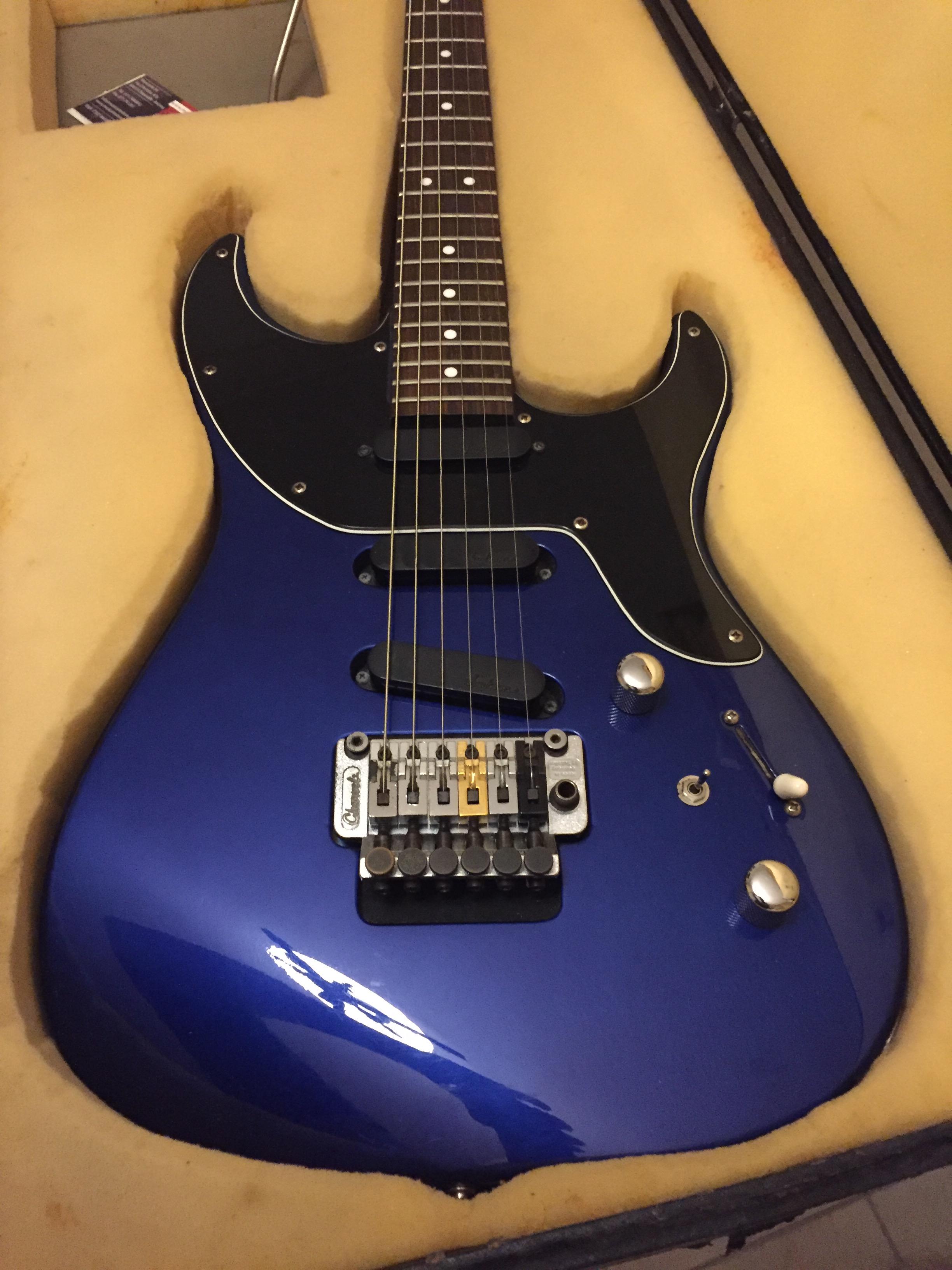

Hey, thinking of letting my dad do some painting on my Charvel. I only want the front doing, so what prep should I do to prepare the surface for painting? Do I need to go down to the wood or just remove the top lacquer ?

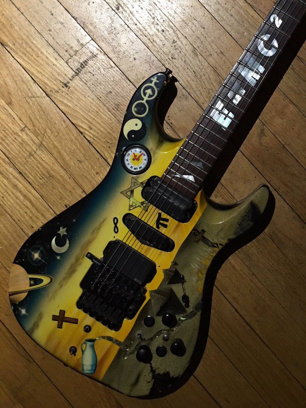

im going for this which VR kindly provided a close up via Twitter 😀

It's MIJ in the nineties so that would make it polyurethane I guess? Details are sketchy on the web I have found.
What colour is the guitar at the moment - because if it isn't black then i'd be inclined to do the whole thing. If it is black then just knock the whole thing back with 600 grit so it's totally flat and then start with your graphics depending on what paint you're planning to use - if using something like Auto Air, it's waterbased so no worries at all and if solvent like H.O.K. just go easy and light to build things up.
Dare say Ben might weigh in with the definitive.
I'd rough up the existing finish like previously mentioned, fill any imperfections if desired, spray your primer coats, and sand flat. Then you're good for whatever.
