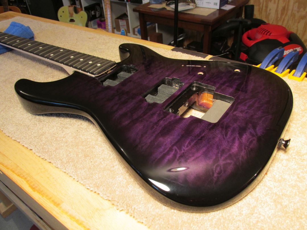

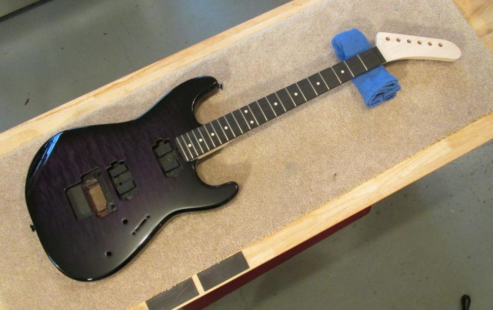

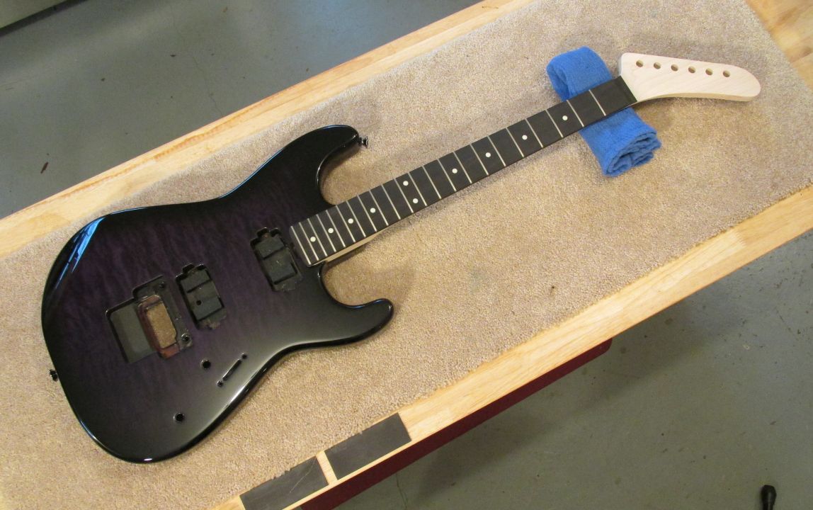

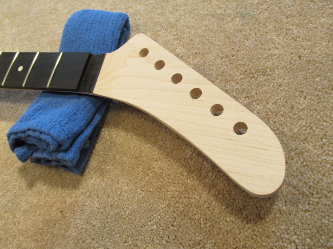

For more on the target platform and for eye candy's sake, here's the destination. Alder body w/quilt veneer (Charvel), maple/ebony neck (ESP, and I will paint the head glossy black and Danish oil the stock of the neck) and it will have an original German-made Floyd Rose.

Beautiful guitar, BTW.  Blue Purple guitars sound better!
