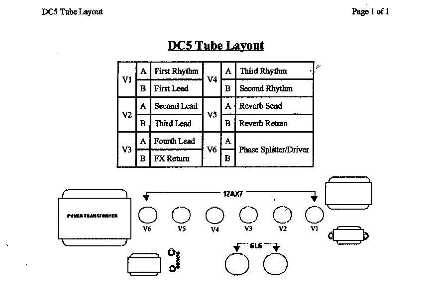

tbonesullivan Posted June 14, 2017 Posted June 14, 2017 So, I finally got my tube guard for the power tubes, and now I'm finally checking out to see what kind of tubes are in the beast. The PO had told me that there was an EH 12AT7 in the phase inverter spot, but I had it serviced, so it is possible it was re-arranged. This is what I found: V1: Tung Sol Reissue V2: Sovtek 12AX7WB V3: 12AT7 Marked U.S.A. - Looks like an RCA - remnants of orange and red letters V4: 12AX7A CHINA V5: EH 12AT7 V6: Baldwin Marked 12AX7 - Sylvania 12AX7WA USA Made So, I guess, what would people recommend for the DC-5? So far I have liked the sound, though the reverb always seemed anemic on the top end. I've put a sovtek 12AX7WA in there, as I have a lot of barely used ones that I usually put in the reverb spot for dependability. What about the 12AT7 as the final lead gain stage and FX Driver? Is there any danger? I really haven't had any complaints about the sound, but I have also wondered if I could get a bit more "beef" on the lead channel. Also I worry that the Sylvania tube is wasted in the Phase inverter spot, but it's got a really big long plate structure, so I worry a high gain spot might go microphonic.
Lockbody Posted June 14, 2017 Posted June 14, 2017 The great thing about the DCs is that other that V1, you can experiment with tubes for one channel and not affect the other. Boogie Board member Edward had a nice cocktail of tubes that he liked. V1: NOS Mullard 12ax7V2: TungSol RI 12ax7V3: TungSol RI 12ax7V4: NOS RCA 5751V5: NOS RCA 12at7V6: NOS RCA 12at7Power: Svetlana "Winged-C" Of those, I liked the 5751 in V4 (2nd and 3rd gain for Ch1) but I had a DC-5a which had a gainier clean channel vs the later DC-5b. I also liked 12at7 in the reverb (V5) and PI (V6) positions. A 12at7 in the reverb V5 is about the best thing you can do for it. Not much help, though. The reverb in the DCs is pretty weak and nothing special. The 12at7 in the PI will help beef up the tone some.
tbonesullivan Posted June 14, 2017 Author Posted June 14, 2017 I wonder which version of the DC-5 I have. I believe since it's got toggle style switches, that would make it a DC-5b, as the DC-5A had Rockers. I also think the tube definitions may have changed, as the lead channel is V1, V2, and V3 on the tube layout chart I have. V4 is supposed to be Rhythm, V5 reverb, and V6 the PI.
Lockbody Posted June 14, 2017 Posted June 14, 2017 No LEDs on the amp to tell which channel is selected and a two-button footswitch that connects at the front means a "B". There are a couple of other indicators, but that's what I remember off of the top of my head. My DC-5a had metal toggles. A good comparison I read is Texas blues vs jazz comping for A vs B. The B's clean is more like a Mark-based clean. When I bought my DC-10, I had its clean channel modded to rev. A specs. A DC-10 is a great way to beef up the DC-5's tone, FWIW! V1 is shared. The 5's manual didn't have the tube layout for some reason, so check out one from a DC-3 or 10. vhttp://www.mesaboogie.com/media/User Manuals/Dual Cal DC-10.pdf The preamp section is the same across all models and revisions.
tbonesullivan Posted June 14, 2017 Author Posted June 14, 2017 AH, I misunderstood. Somehow I thought when you said Ch1 you mean the lead, not the rhythm. That is the schematic I often see, of course I always get confused when looking at the amp upside down. I really do need to take some new pictures of it. I just waxed the tolex and conditioned the corners. Also got the tube guard for the back, which was missing.
tbonesullivan Posted June 20, 2017 Author Posted June 20, 2017 Ok, so it's all good now. I settled on this: V1: Tung Sol Reissue V2: Baldwin Marked 12AX7 - Sylvania 12AX7WA USA Made V3: JJ ECC83S V4: 12AX7A CHINA V5: Sovtek 12AX7WA V6: EHX 12AX7 I also finally got some good pictures of the beast, complete with the new tube guard for the power tubes, which are Winged C SED 6L6GCs
