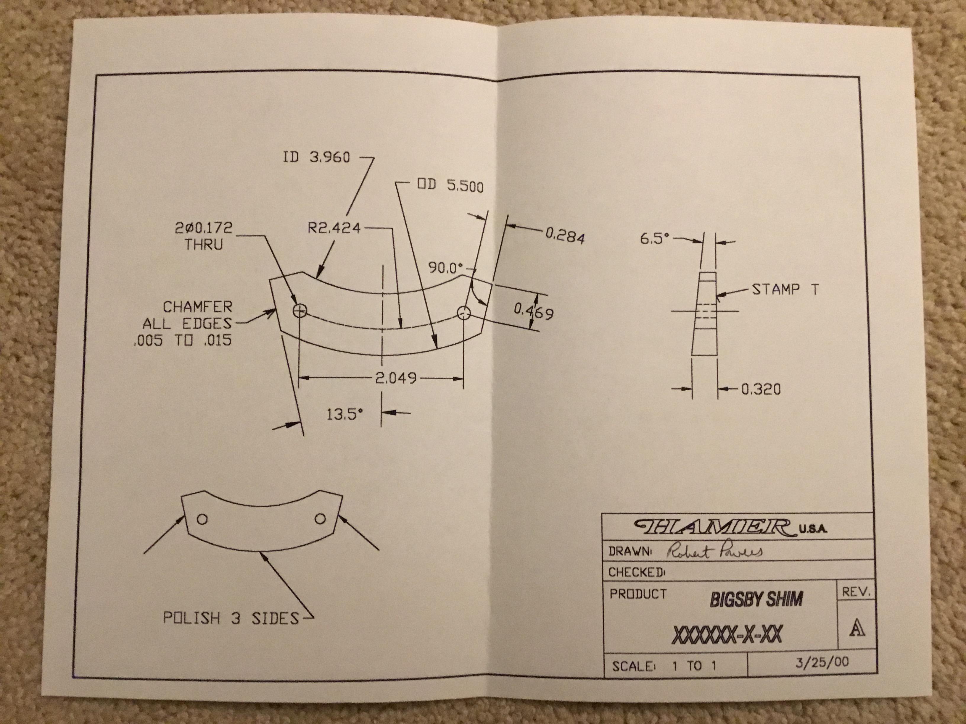

guitarmonk Posted October 2, 2018 Posted October 2, 2018 I have been kicking around the idea of putting a Bigsby b5 on my Monaco Elite. *Gasp* I know there is the B7 version with a Vibramate But I would prefer to do this with a b5 and a shim that goes under the bigsby itself so that it is connected to the body like a Monaco 3. I guess the question begs; Is there any place that carries this particular shim hamer made? I LOVE the B5 on my monaco 3 and I have the best tech in town so tuning stability is never an issue. I guess I'm looking for advice as well...I know conceptually it probably makes more sense to do the B7 but man alive I prefer the look of the b5. Your 2 centavos is most welcome!
burningyen Posted October 2, 2018 Posted October 2, 2018 Hamer used its own custom-machined shim. I doubt you'll find them anywhere unless some former employees inherited them. ETA: Some background on the shims: http://www.buddlejagarden.co.uk/hamerblog/bljan09.htm
mirrorimij Posted October 2, 2018 Posted October 2, 2018 I did the CAD drawing for that and probably have the DXF file somewhere. A decent machine shop should be able to make it (the originals were made by Walter B in the machine shop in the Ovation Engineering department). PM me

mirrorimij Posted October 3, 2018 Posted October 3, 2018 My old XP machine wouldn’t boot. Luckily I had a paper copy. We usually just drew the actual part and machined it. The shim was drawn in 1999. I added the title block, etc much later.

FGJ Posted October 4, 2018 Posted October 4, 2018 9 hours ago, mirrorimij said: My old XP machine wouldn’t boot. Luckily I had a paper copy. We usually just drew the actual part and machined it. The shim was drawn in 1999. I added the title block, etc much later. Not that I'd ever have need of this, but thanks for posting this. I tend to enjoy this kind of ephemera.
