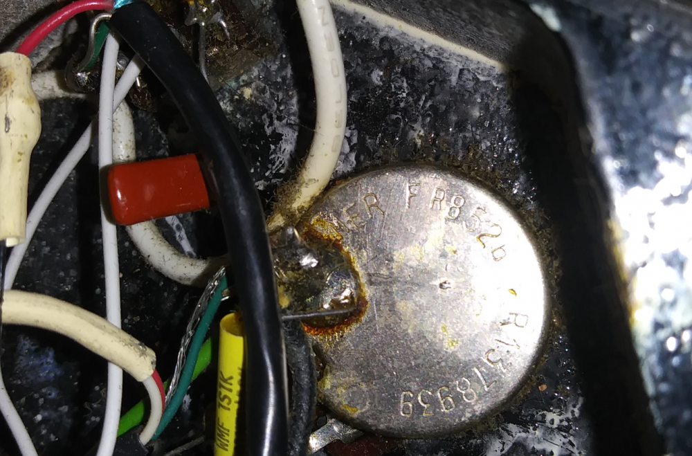

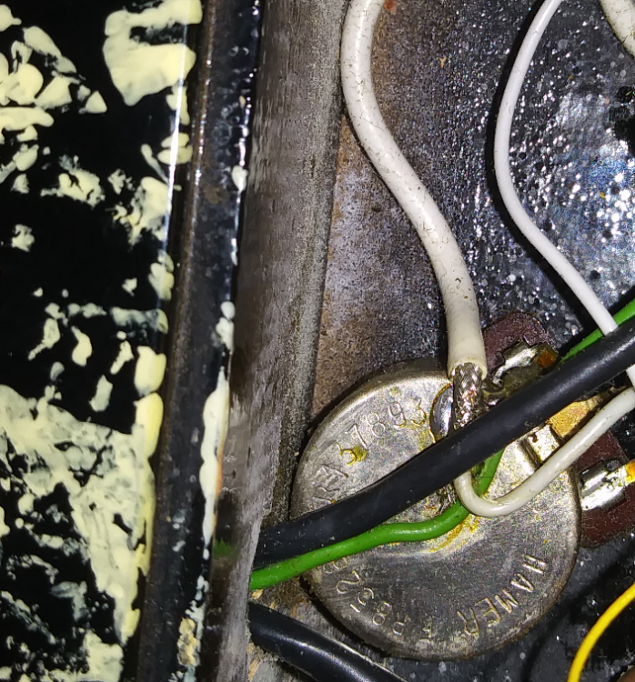

2 pots marked Hamer FR8526. Serial numbers are close R1378939 and R137893 with the last number covered by solder in the second pic. Edited to add that I just checked my red Hamer Special, which I know has Hamer 500k pots. They are also Hamer FR8526.
