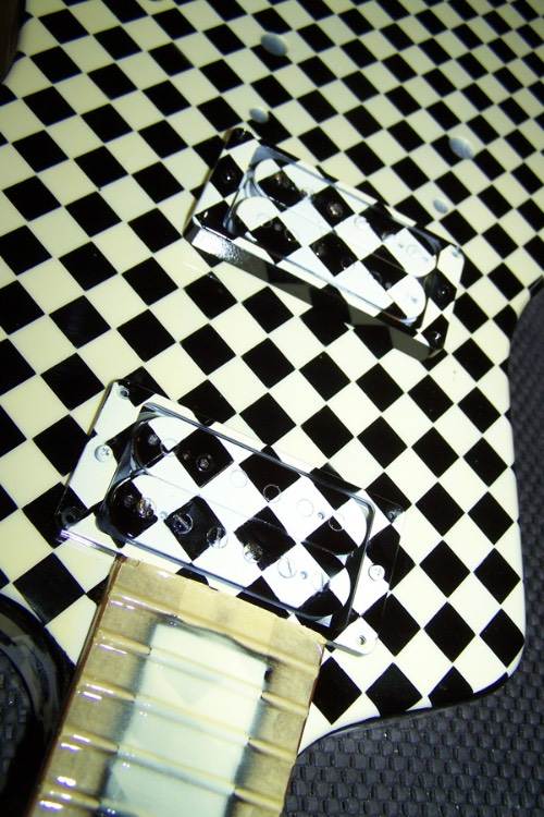

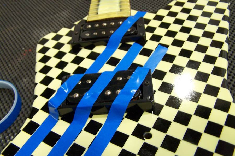

Got a project and wondering if I will have an issue getting nitrocellulose based paint to hold on the bobbins and rings.  I was told this may not work.  Assumed they used nitro on both the original and backup Enola (below).  Is there some kid of prep of the bare plastic to improve adhesion of the paint?
