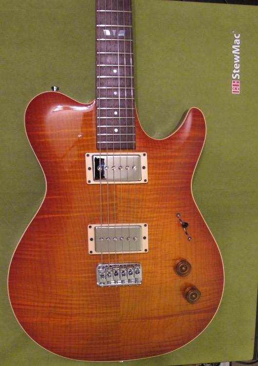

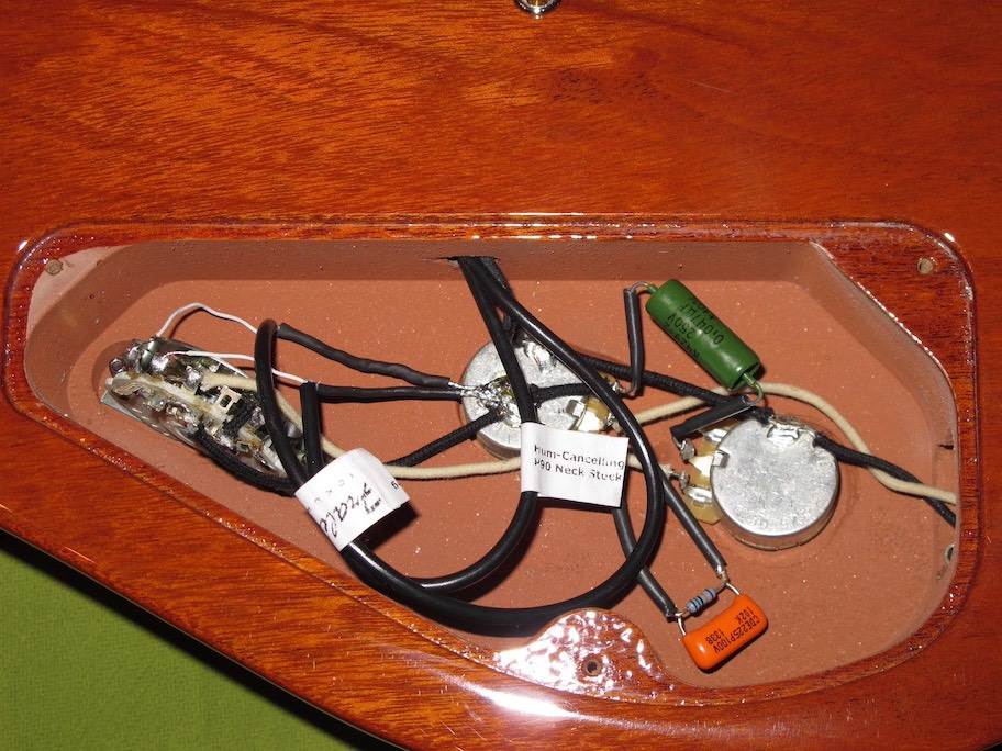

robberns Posted October 26, 2021 Posted October 26, 2021 Wondering if anyone knows what value the stock pots are in a Talladega? Both pots say "Hamer FR8526 0642" on them. I'd have to disconnect the pickups from them to measure but figured I'd ask. Also wondering about he stock 4-way blade selector in terms of wiring. I'm replacing the Duncan DD P90's with some Fralin Noiseless P90's (humbucker-sized) so the pickups are coming out eventually anyway. Fralin recommends 500K pots for those pickups. TIA.
Hbom Posted October 29, 2021 Posted October 29, 2021 I wasn't smart enough to buy a Talladega when I could/should have. So can't really answer your question. But I did stay in a Holiday Inn once. So I can tell you that I bought some NOS Hamer branded pots from Kim Keller in '17 that were listed as Hamer 500K Potentiometers 1997-2014. They are CTS pots marked on the back HAMER FR8526 0814. On my meter they measure: 437,442,442, 443, 452, and 454 I would guess they are similar to what's in your Talladega Doug
robberns Posted October 29, 2021 Author Posted October 29, 2021 Thanks Doug, I was able to measure the tone pot and it appears to be 553. I'm going to leave the originals in and see how the Fralin P90's sound once I get them installed.

robberns Posted November 2, 2021 Author Posted November 2, 2021 Funny, the neck DD is not my flavor of choice. Sounded too dark to me. I had replaced that with a Fralin P92 years ago. But I'm growing weary of the single coil buzz so I am trying a set of humbucking P90's in neck and bridge. I have a wiring diagram from Fralin on the 4-way blade. I'll report back once I get them installed. I'll stash the original DD's in the case for the next caretaker.
robberns Posted November 10, 2021 Author Posted November 10, 2021 Operation No-Noise was a success. I put a set of Fralin Hum-Cancelling P90's in my Tally, and they are in fact, quiet as they purported to be. Guitar sounds much better to me and the pickups blend well together. While I had the guitar opened up I also installed a treble-bleed to the volume pot and a PIO cap to the tone pot. Took down a couple of high frets, re-crowned and polished them and this is better than new.
