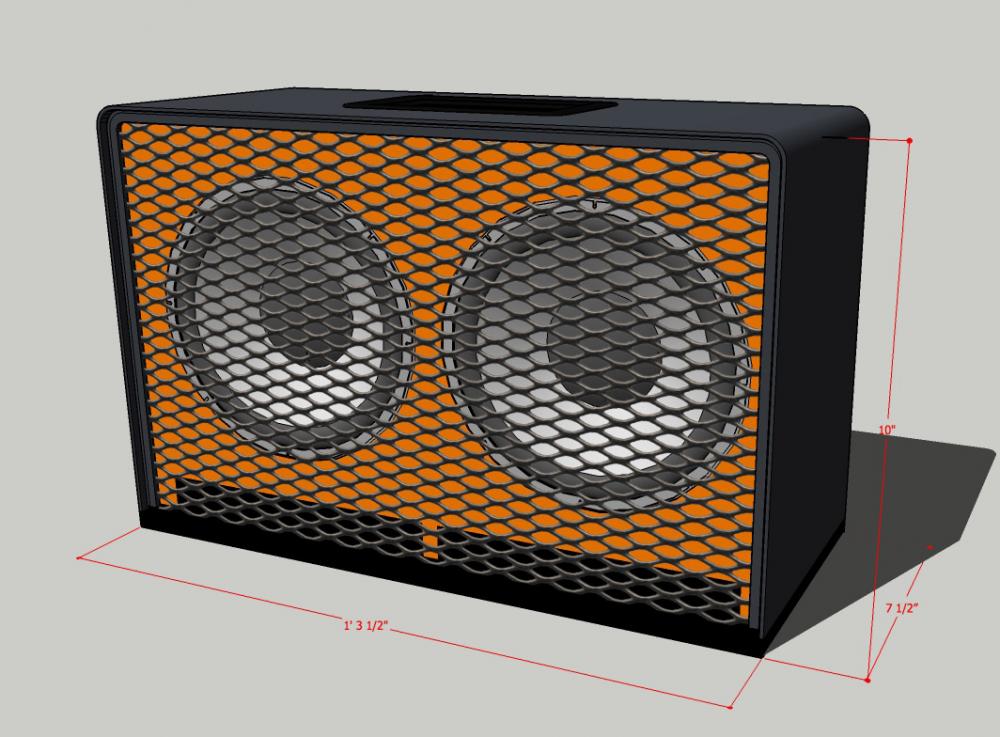

 I'm thinking about building a ported 2 x 6.5 inch guitar cab, using two Eminence drivers; to have a light,  easily portable cabinet would be really useful for me, I only use 15- 25 watt amps on stage these days so power handling wouldn't be an issue, but I'm wondering if it's going to sound nasal, and honky, there's a company called Ear Candy building something like it , claiming they have good low end thump, but precious few audio clips.
 Any ideas and opinions welcomed   Jaberwock

I would love something like that to tame my Blonde Bassman.....trouble is most smaller drivers cannot handle 25 watts per.....
I have a perfectly horrid little Vox Pathfinder 10 that I use as a workshop amp.  Parts Express had a factory overrun deal on some Eminence-built 6 1/2" drivers that were originally meant for an SKB powered pedalboard.  Unfortunately, they seem to be gone now, but they still offer the Eminence 6 1/2 20 watter that looks largely the same, but at a significantly higher price.
http://www.parts-express.com/eminence-patriot-620h-6-1-2-hemp-cone-guitar-speaker-20w-4-ohm--290-8000#!
Anyway, after a little break-in, the Vox sounds considerably less horrid with that Eminence in there.  The nasal/honky is considerably less obnoxious and there's actually some bottom end in there.
CORRECTION:
Thar she blows!  For $12.80 apiece and down.
http://www.parts-express.com/eminence-6-1-2-guitar-speaker-20w-4-ohm--299-402
  Thanks, I saw those 6.5inch speakers, at  $ 12:80 on parts express, I'm sorely tempted, but  noticed the weight was 2.1 pounds, as compared to 3.2 of the 6.5 inch patriot model, so I'm guessing a much smaller magnet, not so worried about a drop in sensitivity, but loosing bass response would be a concern.
Magnet looks to be thinner but a similar diameter.  I've not A/B'ed the two but can speak to the drastic improvement over the craptastic OEM speaker in the Vox.  My search for a response graph for the cheapo OEM came up blank. I did come across a DIY-er who put one in a .25 cu.ft. ported box and got a resonance around 110Hz which, depending on your style, might be a sweet spot.  My cabinet building chops are about on a par with my neurosurgery, so I can't verify that.
