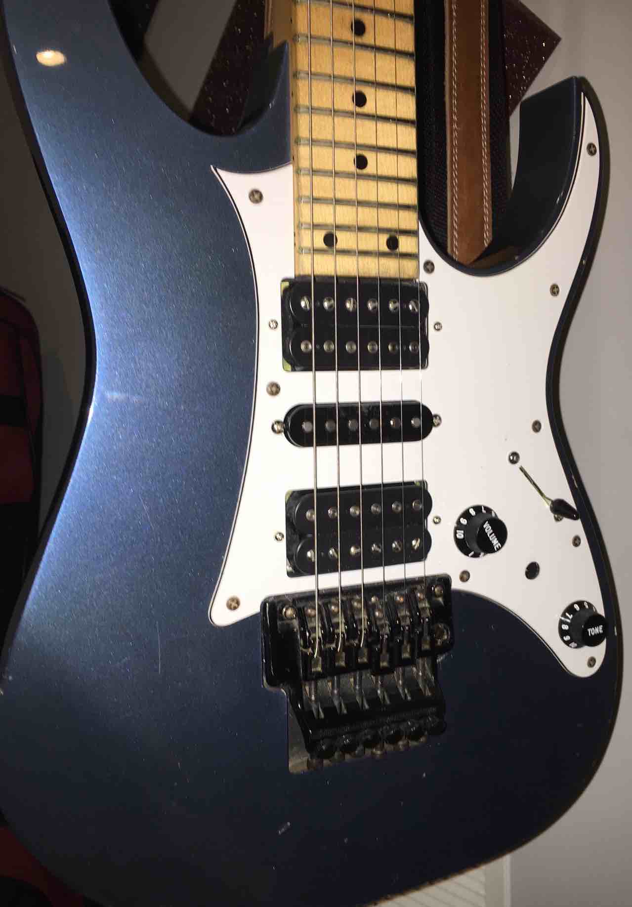

My old Ibanez RG550 from '87 has the rear cover plate for the output jack with one screw that won't stay in.   I chipped away some wood to fit a battery in there ages ago, and over time the one screw's surrounding wood has gone away.  The screw won't stay in now.  What would you guys suggest to fix it?  Picture shows what I'm talking about.
Thanks.
Scott

Seriously, drill out the hole to accept a very small length and glued-in small diameter dowel, then re-drill the dowel and re-screw. You can use cheap dowel material from a Home Depot or Lowe's since it's just holding a plate on and not under any kind of tension or torque or anything. And since the mod will not require any real precision and will be concealed by the plate itself, you can use a hand drill - no drill press needed.

The dowel is a good idea.
Other things you could do are:
Mix sawdust and yellow Elmers carpenters glue.
Apply it to both sides of the hole trying getting it completely filled.
Then drill it out for the screw.
Or:
Get several tooth pick, cut them to size and fill the hole partially, then screw the plate back on.

Thanks, but I've been the toothpick route.  Over time, the one side has flaked away, so the toothpicks won't work anymore, sadly.
Yes, yours was more of a grand canyon epic hole to fill.
Dowel was/is the way to go.
Yeah, definitely.   When I put EMGs in, I chiseled away enough to put a 9 volt in it.  Clearly my 19 year old patience and skill were sorely lacking.
