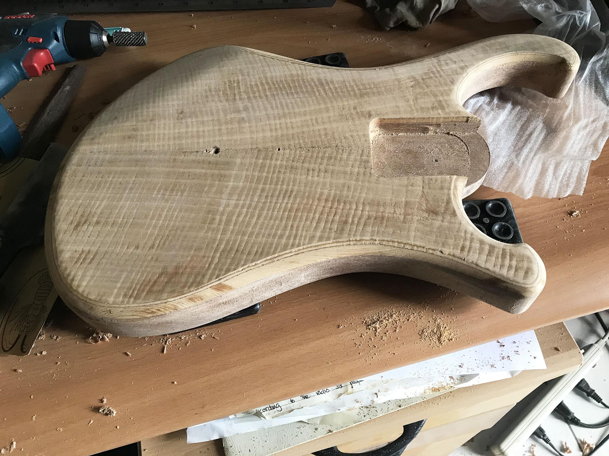

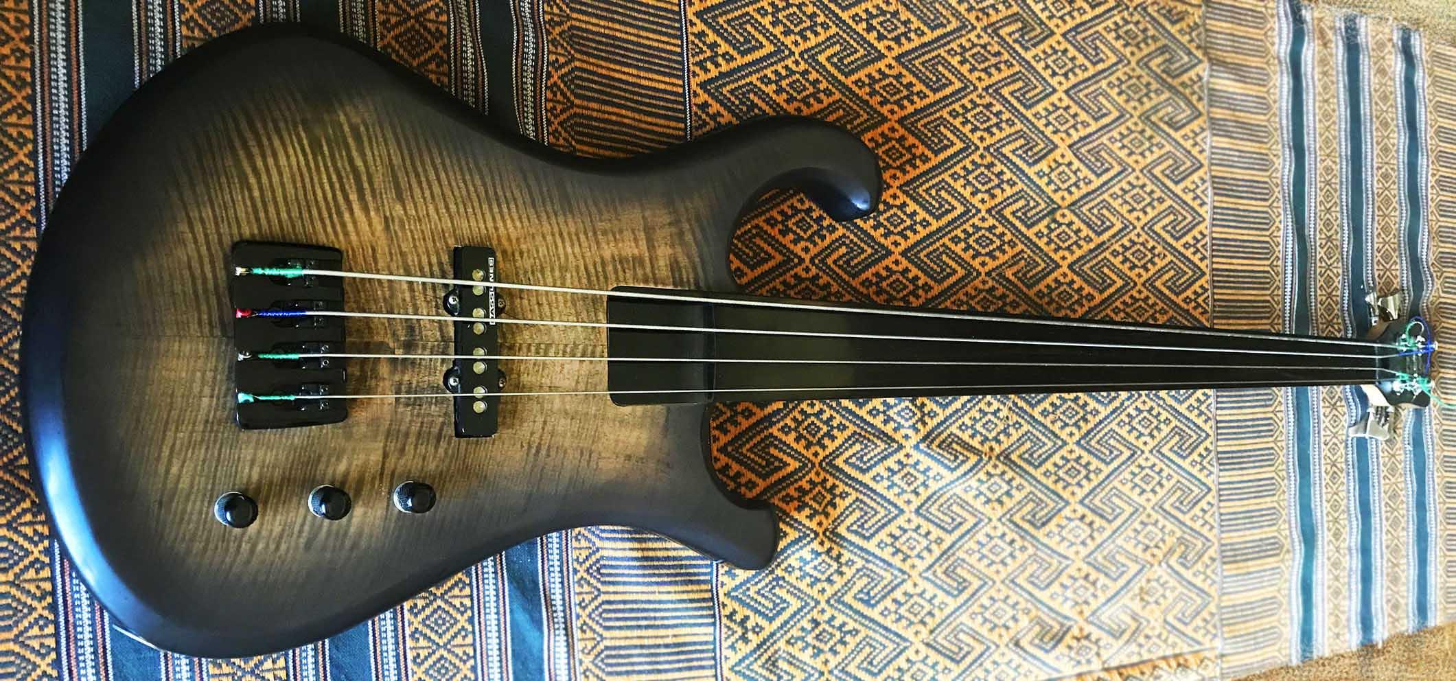

I bought a Warwick Rockbass  fretless neck second for fourty nine bucks on ebay, surprisingly good; didn't have much of a budget, but using wood left over from another project, and GFS parts, I managed to put this together for just over two hundred and fifty dollars.
 The mahogony body works well for fretless, really brings out the "mwaaaahhh" and overall super happy with the way it sounds and plays; using a veneer top however was a huge mistake, it created a lot of extra work, for the sake of an extra seventy bucks !!

Great build! Have fun with it. The burst is really nice too!

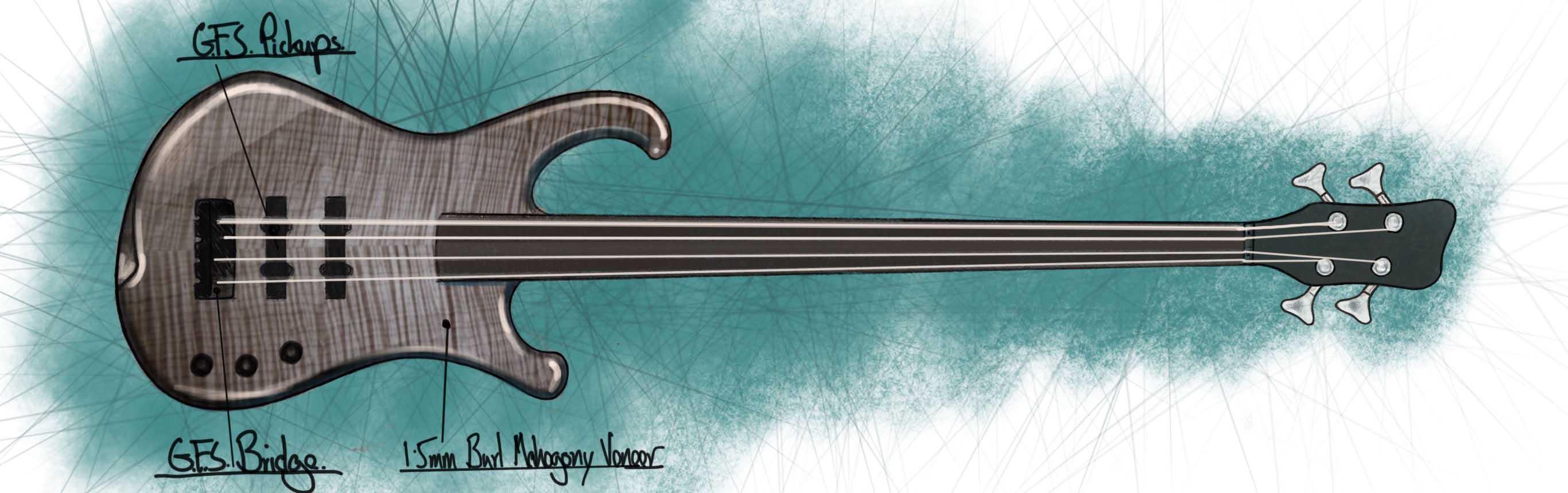

How did you decide on the pickup placement? (Looks like it's closer to the neck pickup in the drawing but still somewhere between the two)
For me the bridge pickup tends to sound a little honky, and the neck a little wooly, so I went in between; Im planning on changing to a Bartolini MM4C when funds allow.
 I'm probably still in the honeymoon period , but it's better than I ever could have hoped for, both sonically, and aesthetically.
