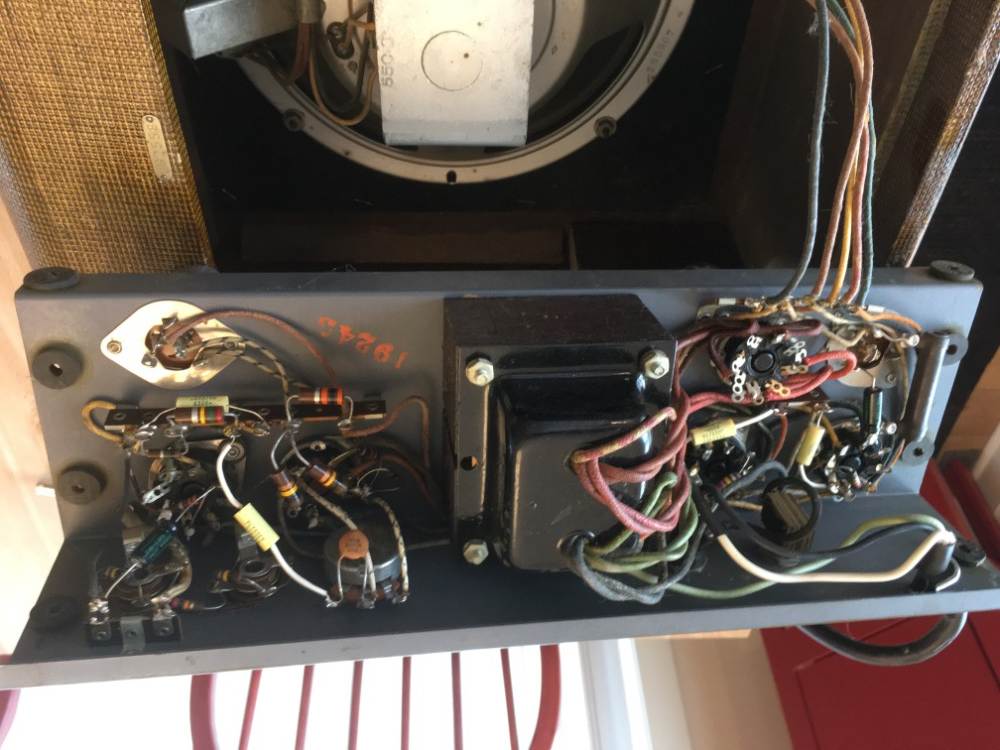

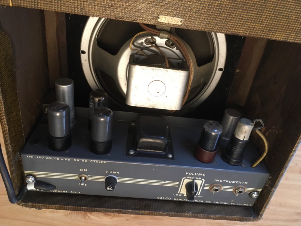

I'm pretty sure none of them have ever had their filter caps replaced- even the 72 year old Valco. I'm assuming the shiny aluminum cans are the main filter caps, correct? The last time I powered it up 5 or 6 years ago it worked fine. There are a few of what appear to be newer coupling caps inside, but the Mallory Type FP caps appear to be original.

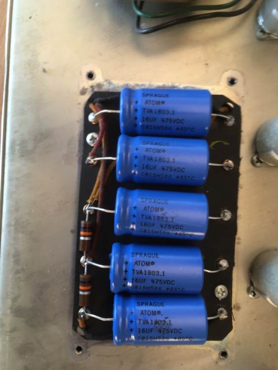

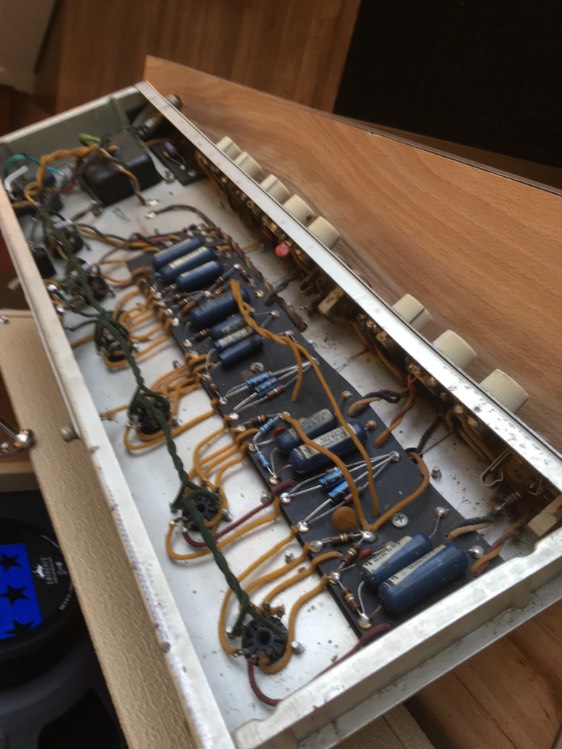

I opened up the Tremolux to find that the filter caps have been changed- at least they look newer than the rest of the components.
That Tremolux looks beautiful. The safe thing to do is to have a tech slowly bring them up on a variac.
