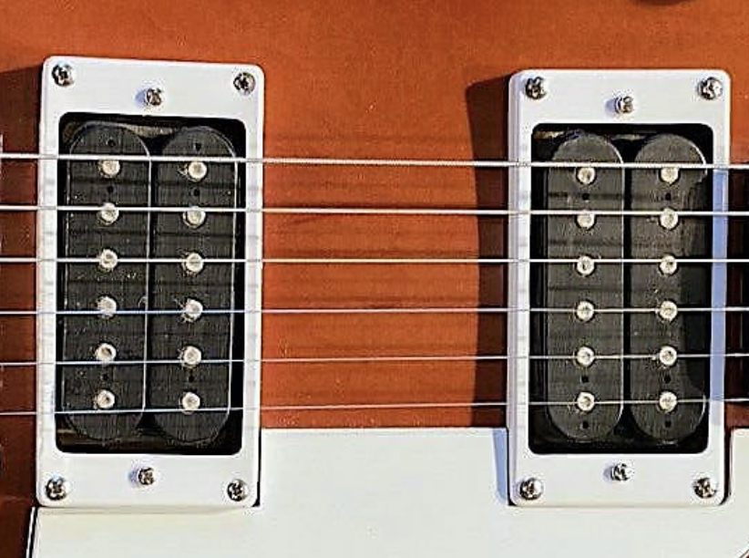

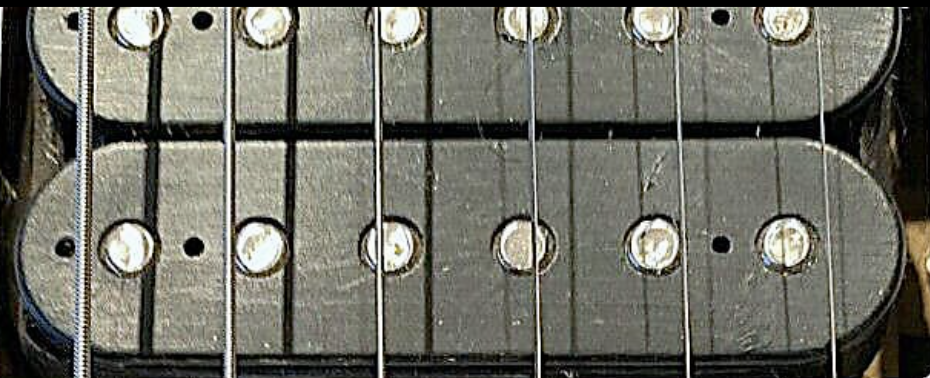

cynic Posted May 17, 2021 Posted May 17, 2021 Any familiar with a Dimarzio model with no adjustable poles? These are being represented as Dimarzio but I can't recall seeing them before. Secondary question, does anyone have a guess what year Dimarzio started offering double blacks?
JGravelin Posted May 17, 2021 Posted May 17, 2021 Late 70s, 49.2mm spacing, usually around 8.7k +/- with A5 mag. I've had a few of these on my bench, all from Hondo guitars. Oh hey, I just found this: https://samick.fandom.com/wiki/DiMarzio_K-10
cynic Posted May 17, 2021 Author Posted May 17, 2021 Thanks Josh, that's perfect info. FTR, they're installed in a ridiculously priced 70s LP style bolt on listed on Reverb. I was asking more for my own curiosity than anything else.

JGravelin Posted May 26, 2021 Posted May 26, 2021 The ones I've had must have been neck pickups, at the bottom end of the listed spec. Beyond spilled booze drinks, human sweat, humidity, and other factors that lead to pickup failure; the flux core of solder back then ...over time, it's corrosive and will cause internal shorts that will ruin pickups. If the bad zone is on "finish" end of the coil, depending on where exactly sometimes I've been able to fix it with a new internal output wire and fresh solder. If the corrosion is at the beginning of the coil, with the way DiMarz and others had done it back in those ye olden times, there's no way out. Sad+++ I use modern NASA-approved Eutectic solder: non-corrosive flux, hyper-resistant to heat fluctuations, and will be stable and functioning properly long after we're all dead and gone. Modern tech isn't always like this despite the claims of "New = Better!!!". In this, with this stuff right here tho -- ya, bud! Count me as a fan of double slugs and the extra inductance to drive an amp a bit harder for maximum sparkle and rawk.
