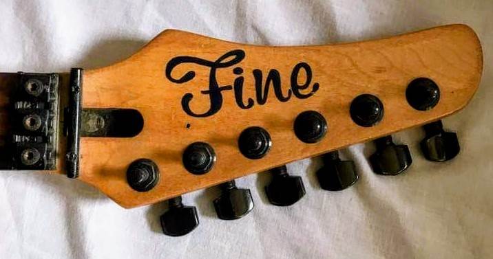

I have a Centaura personal project I should probably wrap up. I had some Hamer logos kicking around that were probably a smidge larger than what was originally on there but I said fuck it, it's definitely an improvement to how it was when I got it.
Oh yeah, anyone have a black truss rod cover for a Centaura? 😄FB_IMG_1637527189964~3.jpg
