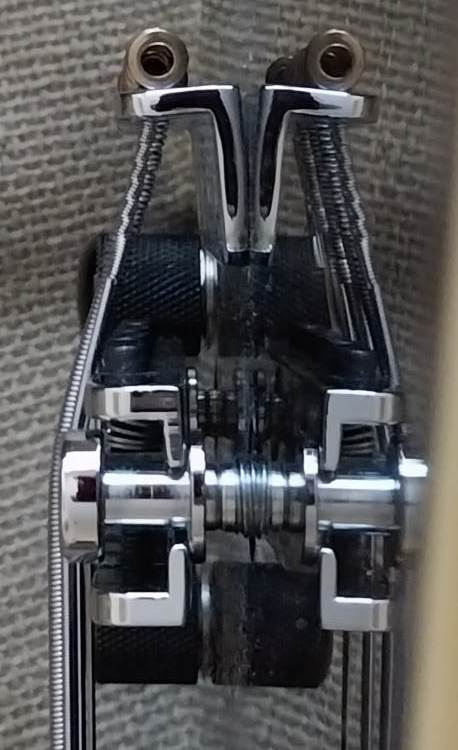

HSB0531 Posted September 18, 2023 Posted September 18, 2023 I have a 2010 Standard 12-string bass and I just noticed that the rear part of the tailpiece is lifted slightly off the body. Is this a common occurrence? Is there a fix for this?
topekatj Posted September 19, 2023 Posted September 19, 2023 Cool photo (reflection), I assume there’s a row of anchor screws that are intended to hold the L bracket (where the strings anchor) flat against the body. For starters, loosen the strings and see if those screws are tight.
HSB0531 Posted September 20, 2023 Author Posted September 20, 2023 6 hours ago, topekatj said: Cool photo (reflection), I assume there’s a row of anchor screws that are intended to hold the L bracket (where the strings anchor) flat against the body. For starters, loosen the strings and see if those screws are tight. Yep, That's all it was! I got scared because there's some 12-string bass site where someone mentioned the "flawed" design of this particular tailpiece and the back end lifting off the body.

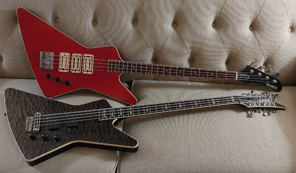

HSB0531 Posted October 4, 2023 Author Posted October 4, 2023 On 9/20/2023 at 12:09 AM, topekatj said: That’ll be $500- please. JK, glad that is all there was to it! is the bass black? Let’s see some photos! Yes it's black:
