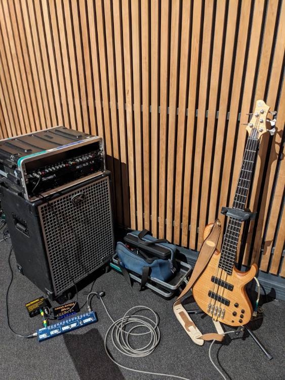

Quite a while ago I got a GK Neo 2x12 (first gen neo I think, 46 pounds iirc). I've been really happy with this 212 for about 15 years now, I usually turn the tweeter 'off'. I had a 1x15 Neo to go with it for a while, but I don't really play loud often or outdoors, the 1x15 did sound really huge with the 212.  I have a variety of amps, my favorite is a '68 Ampeg B25, but it's only 50 watts ish.  I also like my old rack setup with a Stewart Audio "world 1.6" pa type power amp, and a couple of preamps.   If I were to need loud, I'd add a single 15 cab, and I wouldn't bother with Neo for the single 15, the weight savings from just one speaker wouldn't be all that much.
 - to your original question, to my recollection, the GK neo 2x12 sounds every bit as good and loud as the old Eden 410xlt.
