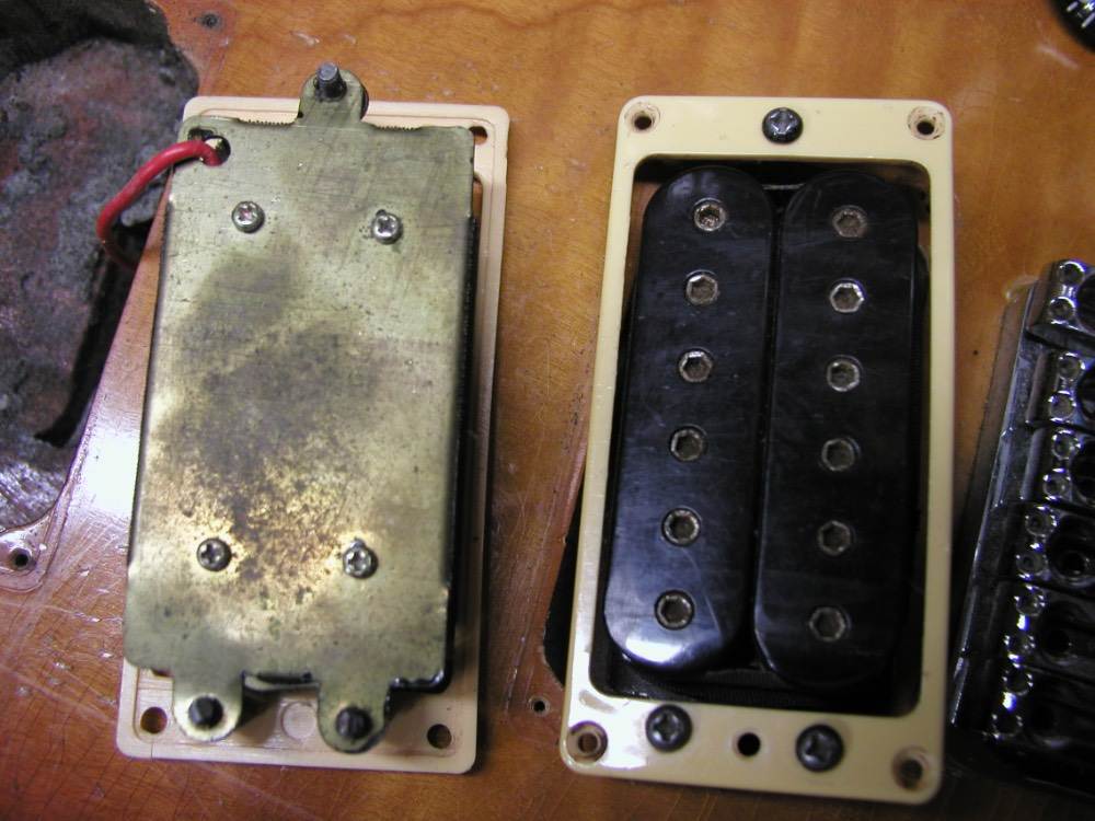

BadgerDave Posted October 11, 2024 Posted October 11, 2024 Anyone have ay idea what these might be? They were installed in the 80 Special that Dave's recently had listed.
kizanski Posted October 12, 2024 Posted October 12, 2024 I’m no detective but I think I know who bought that 1980 Special from Dave’s with the headstock repair and the changed out pickups.
Cboss Posted October 12, 2024 Posted October 12, 2024 What is the DC resistance? The three adjustment screws look like ibanez/maxon to me, double hex pole pieces could be a V2, their version of a super distortion (excellent) Congrats on snagging that guitar, that was really beautiful and a good price
Victor (Fret Friend) Posted October 12, 2024 Posted October 12, 2024 Based purely on the hex poles, I'm guessing a Dimarzio Super Distortion. It would be about right...
BadgerDave Posted October 12, 2024 Author Posted October 12, 2024 11 hours ago, Cboss said: What is the DC resistance? The three adjustment screws look like ibanez/maxon to me, double hex pole pieces could be a V2, their version of a super distortion (excellent) Congrats on snagging that guitar, that was really beautiful and a good price These measure 13.13 and 13.44 ohms. I'm guessing they're ceramic magnets and would be more appropriate for a much pointier guitar.
BadgerDave Posted October 12, 2024 Author Posted October 12, 2024 3 hours ago, Victor (Fret Friend) said: Based purely on the hex poles, I'm guessing a Dimarzio Super Distortion. It would be about right... Super Distortions would have DiMarzio markings engraved on the back of the baseplate and 2, rather than 3 mounting tabs. These probably sound similar though.
Cboss Posted October 12, 2024 Posted October 12, 2024 6 minutes ago, BadgerDave said: These measure 13.13 and 13.44 ohms. I'm guessing they're ceramic magnets and would be more appropriate for a much pointier guitar. At that DCR I'm pretty sure those are Maxon V2s, which are alnico 5. Their version of a super distortion.
Cboss Posted October 12, 2024 Posted October 12, 2024 3 hours ago, Victor (Fret Friend) said: Based purely on the hex poles, I'm guessing a Dimarzio Super Distortion. It would be about right... SD 2 mounting screws/tabs
luis Posted October 23, 2024 Posted October 23, 2024 Sure Murkat. Japanese put DiMarzios clones by Maxon or Gotoh on their early 80s guitars, Aria/Matsumoku guitars but also Tokai ( I have one on my parts bin).
