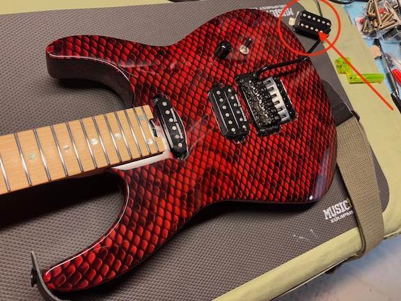

Thank you buddy! I did the reset and (I guess) it worked given I was finally able to anchor the ground lead to the volume pot. How coincidental that you provided the info needed to install one of your double slug Mongoose p'ups in my Charvel. :)
