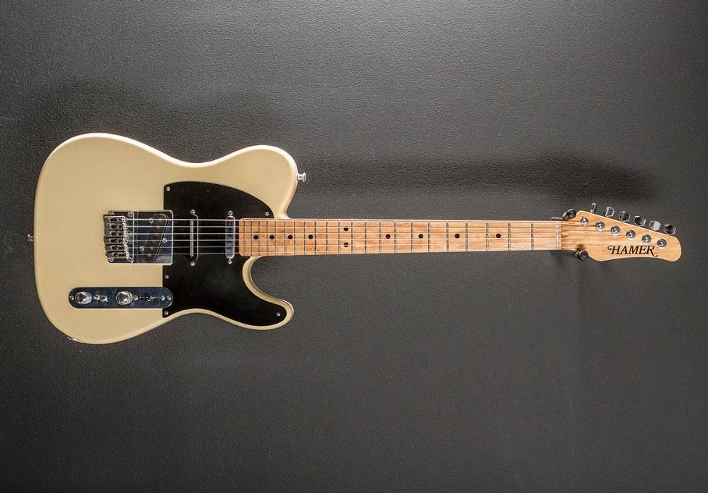

hamerhead Posted November 12, 2025 Posted November 12, 2025 As you know, I picked up what seems to be a fairly rare Nashville(?) T-51F From Dave's: Great little guitar. Everything appeared to be original, except for the added mini toggle, possibly the pots, and the associated nasty wiring. I did a quicky rewire to make it functional from stuff I had laying around (it's not pretty), but now would really like to put it back to the way it came out of the factory. The problem is, I don't know what that is. The Fishman and middle pickup takes it out of the 'normal' Tele realm and I don't know where to even begin looking. Help! ...here we go again.... Quote

velorush Posted November 12, 2025 Posted November 12, 2025 (edited) From this thread: It appears stock wiring omitted the Tone control to maintain the standard two-knob layout and provide a volume control for the Piezo. Logically then, the Piezo volume would come after the switch, wired as a Blender knob. ETA:? That was posted as a statement whereas it should have been posted as a theory - I have no idea. I'd be really tempted to go with a stacked pot on the Tone control to keep a Tone for the electric pickups and a Volume for the piezo. Edited November 12, 2025 by velorush 1 Quote
velorush Posted November 12, 2025 Posted November 12, 2025 Just found this photo of a "Dead Mint" example and it has the same mini switch: Could it be, rather than a blend knob, the piezo circuit is enabled by the mini switch? I hadn't taken that possibility into account due to the comment above of "added mini toggle." 1 Quote
velorush Posted November 12, 2025 Posted November 12, 2025 Found this thread that provides even more information: Sorry to be bombarding the thread, but I have a very technical email I am trying to compose and the distraction is helpful for getting my conscious brain out of the way of attempted expression (or something like that). 🤔 2 Quote
Victor (Fret Friend) Posted November 12, 2025 Posted November 12, 2025 Nashville's with piezo have a stacked pot. Sure I had a wiring diagram way back: I'll look for it but don't build your hopes up: my backup drive fizzed out on me and as things are I can get nothing off of it... 1 Quote
hamerhead Posted November 13, 2025 Author Posted November 13, 2025 2 hours ago, velorush said: ... I hadn't taken that possibility into account due to the comment above of "added mini toggle." It had 2 mini toggles when I got it - 1 looked stock (not sure if it was), the other kinda jammed in along side it. My pea brain couldn't comprehend it all, as neither functioned in a way that made sense to me. Which is why I was wondering what the stock configuration was. Not sure about a blend control. I mean I get it, but the separate volume on the Fishman should accomplish the same thing, no? If I can't find out how it came from Hamer, I'd go with a stacked pot for the normal pickups, a regular volume control for the Fishman, and no blend/mini switches at all. The cleaner the better. Who from the factory might have such knowledge? Who was their wiring guy? Is there anyone I can ask? 2 Quote
