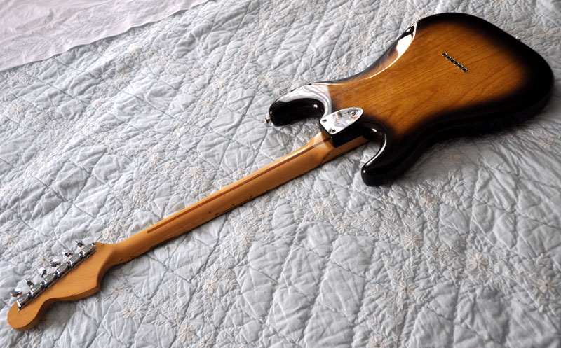

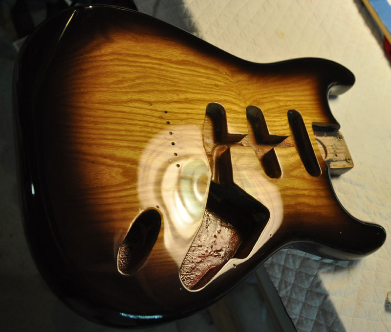

There's a thread around here somewhere. Picking an ash '75 Strat for my first project probably wasn't the smartest thing ever, but I couldn't have been more pleased with the way it turned out.
