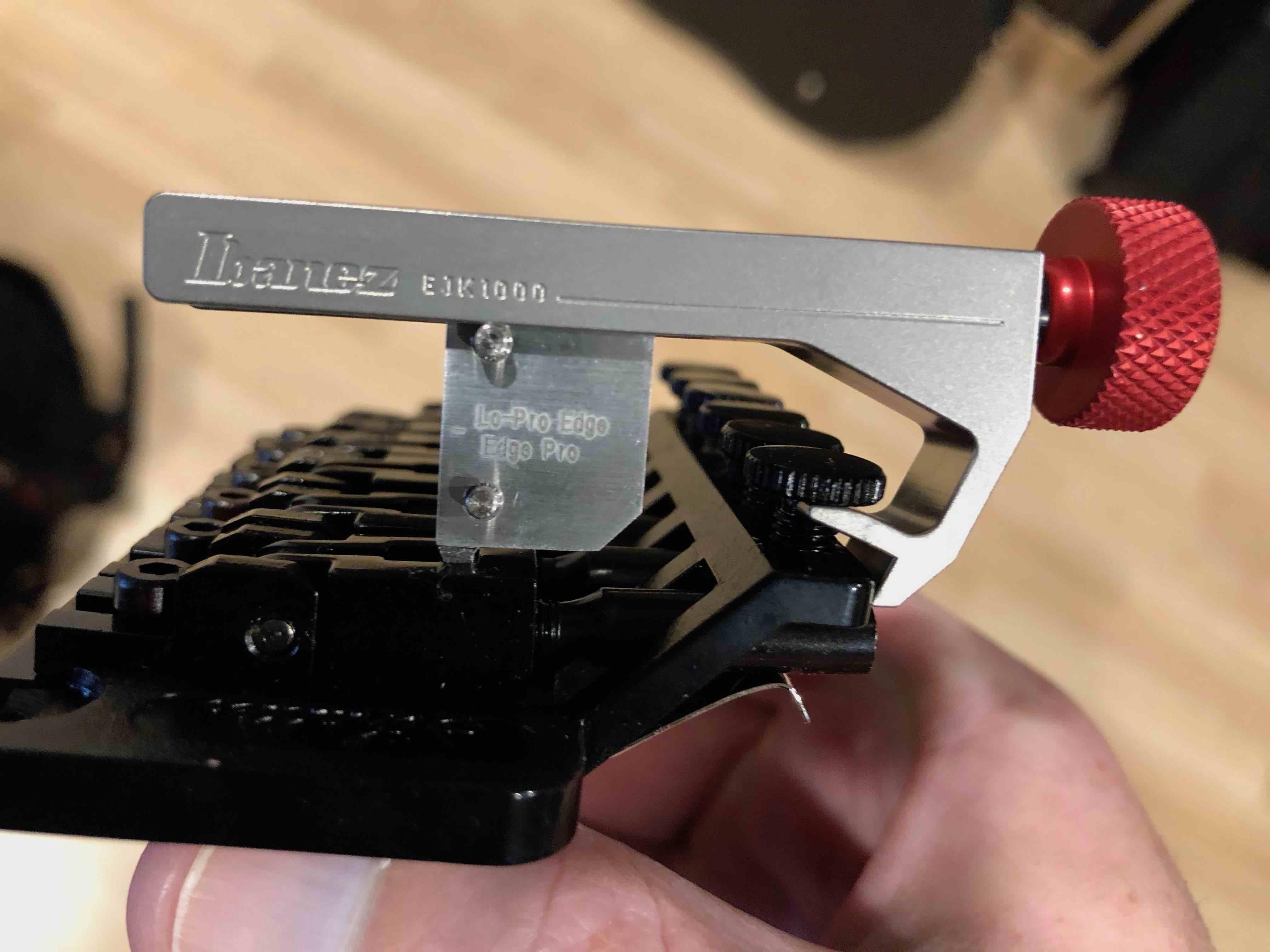

scottcald Posted August 26, 2018 Author Posted August 26, 2018 The one for the Ibanez I saw seemed to hook around the fine tuners and slot into the back of the saddle itself somehow, which is what made me wonder about the Schaller. https://www.bam-music.com/en/ibanez-ejk1000-e-jack-intonation-adj-tool.html

scottcald Posted August 30, 2018 Author Posted August 30, 2018 Wanted to follow up on this. Before Jeff answered, I went ahead and ordered the Ibanez tool on Amazon. Turns out it works! I had to file the "tooth" that grabs into the saddle, but that was under 2 minutes of work with not that good of a file. I set intonation of the low E with it with no problems. Hope this helps anyone else with a Schaller.

scottcald Posted August 30, 2018 Author Posted August 30, 2018 Yeah, I had ordered the shorter Floyd style screws initially to see if I could use the key with them, but they don't stick out quite enough. Actually I should say I contacted Schaller and they simply sent them to me.
scottcald Posted August 30, 2018 Author Posted August 30, 2018 Here's a pic on a new Schaller for another project: The fine tuner has to be most of the way up, but that's not a big deal.
Jeff R Posted August 31, 2018 Posted August 31, 2018 Ah, it pulls back from the saddle's clamp block hole, not the clamp screw like The Key. Nice, and smart!
scottcald Posted August 31, 2018 Author Posted August 31, 2018 Yeah, it's engineered pretty well and has a second threaded hole for their different trems. Wasn't sure it'd work, but it's a nice solution.
