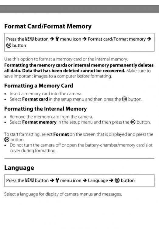

39 minutes ago, Steve Haynie said:
The camera has no formatting utility.
Page 134 of manual:
7FC732AD-14C3-402B-A575-E0A0EB9AE0A5.jpegHope this helps Steve. Just trying to help. I’ve got the same Nikon.
