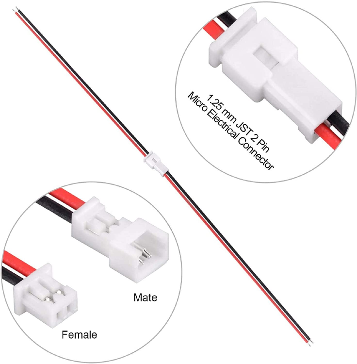

1 hour ago, cynic said:
To execute the idea above without the need for buying a tool, you could buy these and just splice them in.
Might go with this for the faster to implement option.
