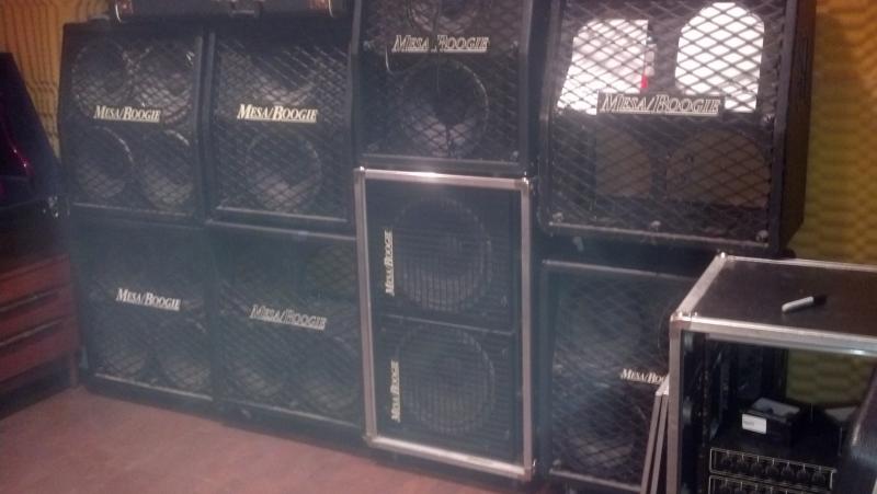

Edited to add something to consider as a Plan B ... I recently bought a big lot of assorted 12-inch guitar speakers via local CL to keep one or two for me and turn the rest for a little profit. One of the batch was a mint clean Black Shadow MS-12. My plan was to pull the replacement 100-watt Celestion G12K-100 in my Boogie wide-body vertical 2x12 and put the MS-12 in its place. I've used Boogies for decades and always loved the MS-12s in my old iron-grate-faced M/B cabs.
The 100-watt Celestion won the shootout for my ears in both clean and gain tests at both low and high volumes. Bolder low end without being obvious about it, and it made the MS-12 sound overall tired and flat, if that makes sense.
The G12K-100 is now very nicely paired with a mid-80s Celestion 75-watter from that CL batch, that simply SLAYED the current production Celestion Vintage 30 that was stock to the 2x12 cab.
