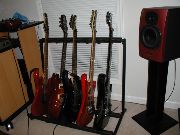

jettster Posted February 9, 2016 Posted February 9, 2016 I've been using this one for 12-13 years without any issues.
