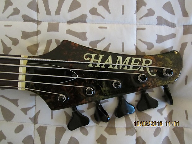

The early Chap 5 basses started off with 4+1 headstocks. The dual-truss, setneck ones were mostly reverse headstocks and 5 on a side..".BUT not all 5-on-a-side ones are dual-truss. Ask the seller. Look for a really wide truss rod cover. The reference IMG_4758.JPGphoto below,I think, is a single truss rod one.
They also made bolt-on ones....and import ones. So it gets a little confusing.
I even ran across some later ones that are setneck but single truss rod. This one below, was advertised as a 1992 but is obviously a single truss from the cover. But it was a custom order with the Irridescent paint job and Bartolini PUPs, so maybe the original owner asked for a single truss rod to reduce weight or aomething? Or the seller had the year wrong.
