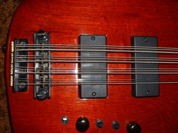

Stevieconlon Posted March 22, 2005 Posted March 22, 2005 I agree with Dry. The Bartolini classic bass pickups rock!Mine were two-hole, not three also.I mounted them in my 76 Ibanez "lawsuit" T-bird conversion.I use the Aguilar 3 band preamp.I find them to be much more "transparent" sounding compared to the EMGs in my B12L.Check it out:http://www.12stringbass.net/Conversion2.htm
