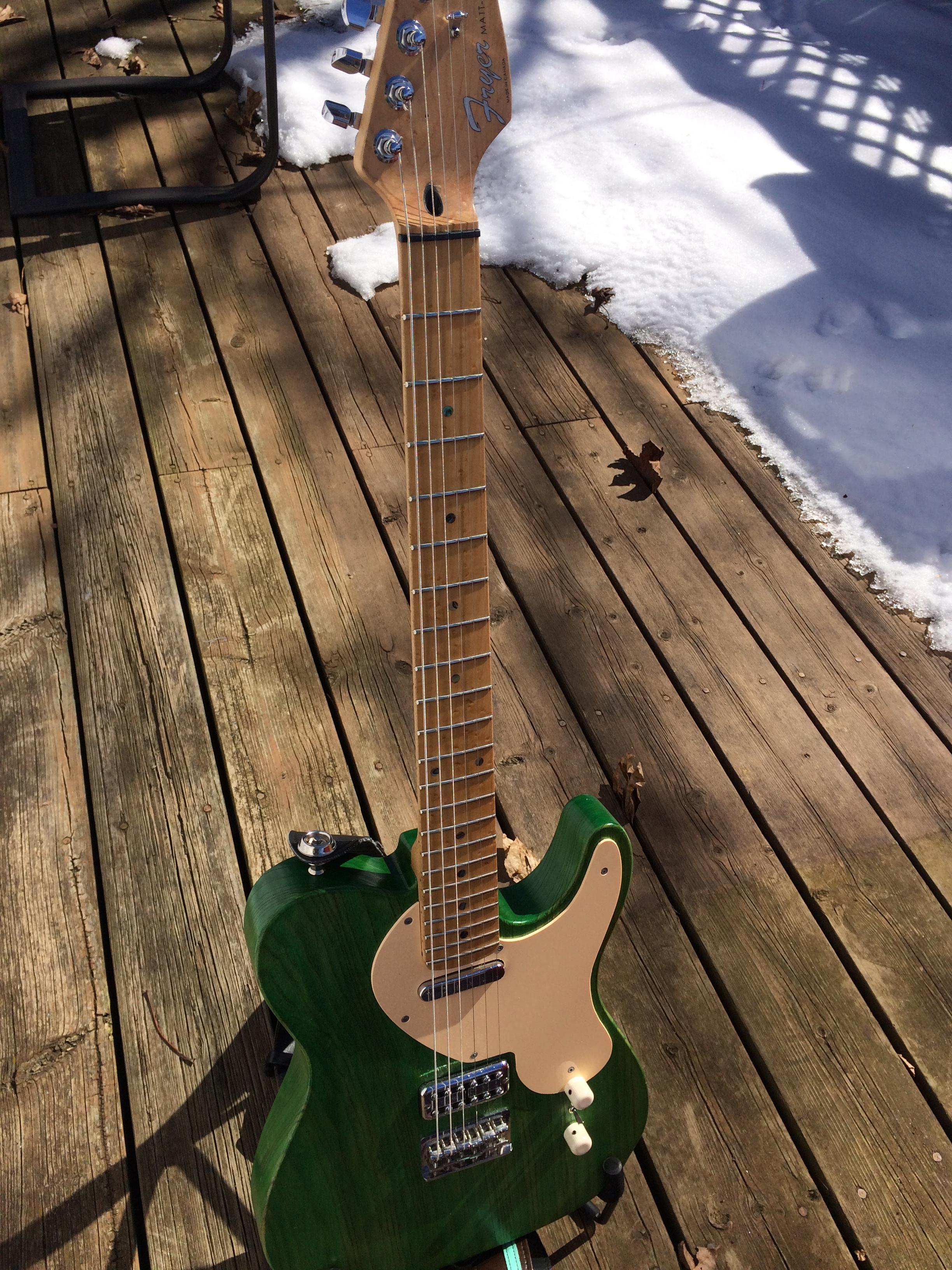

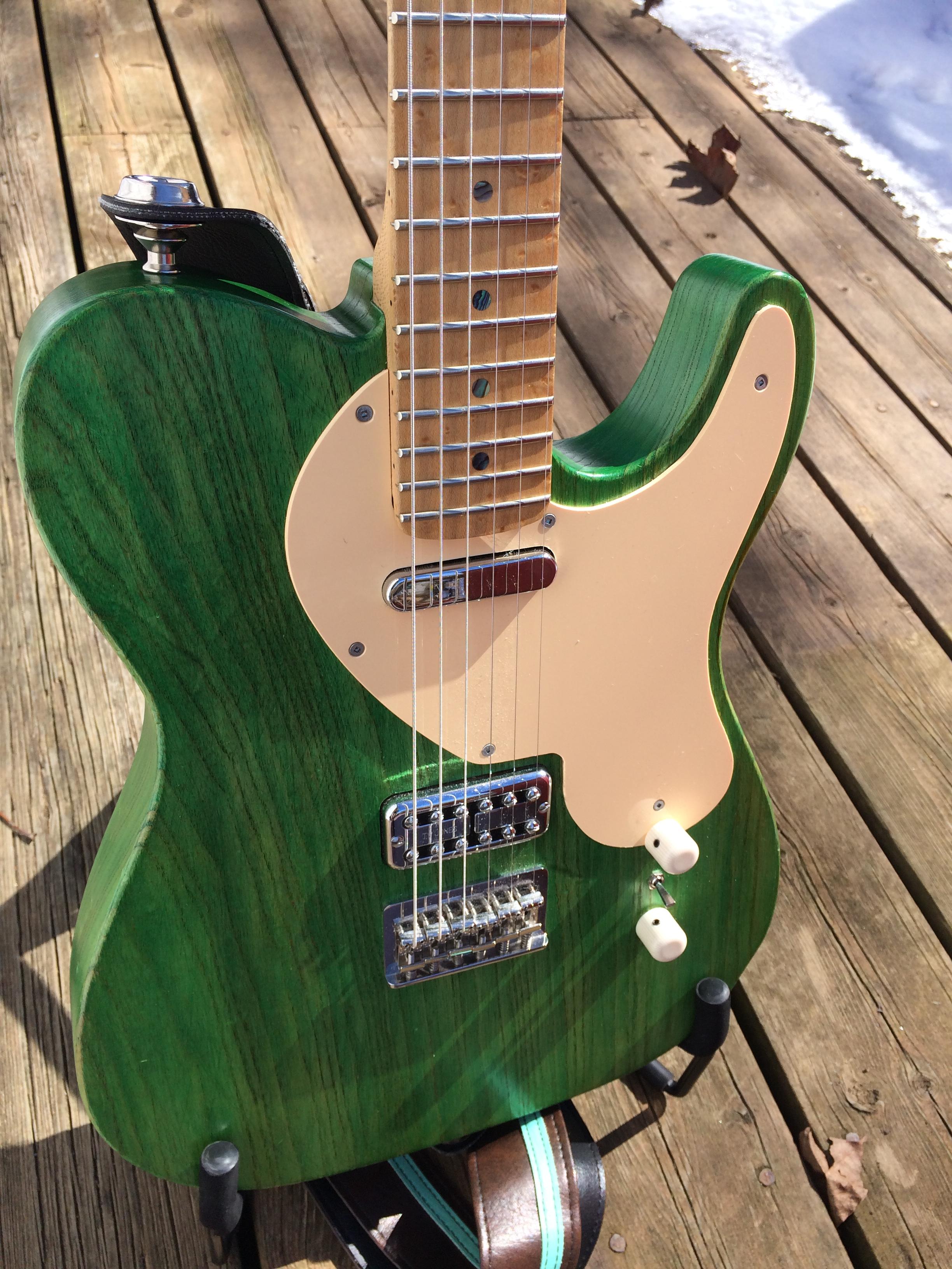

I use Minwax Wipe-On Poly which is actually a Tung oil blend. I just finished a 12 string Tele build . I like the satin. Rickenbacker recommends it for their oil-finished instruments like the 650D I had.
The Minwax WOP is similar to Tru-Oil and I have used both. I like the satin WOP better because it builds up slower and doesn’t get glossy. I do love an oil-fished neck.
Lovely fretboard on her :)
