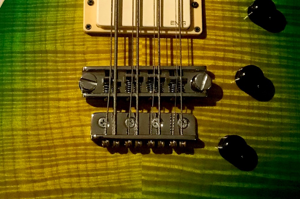

Ham Rex Posted September 9, 2022 Posted September 9, 2022 The 8 string bass I have has GHS Boomers 20-90 90-45 70-45 55-25 40-20. Is there a different size or brand I should try? Please note this one has the high octave string below the main string. I see most have the high octave strings above the main string. Thank you in advance.
