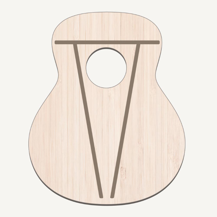

Yep. I have something similar, only slightly less on the soundhole side. This a Lemon Grove built 555 and likely has older stiffer bracing than Taylor's newer bracing schemes. Pic above is the V class stuff reduced to basics.
