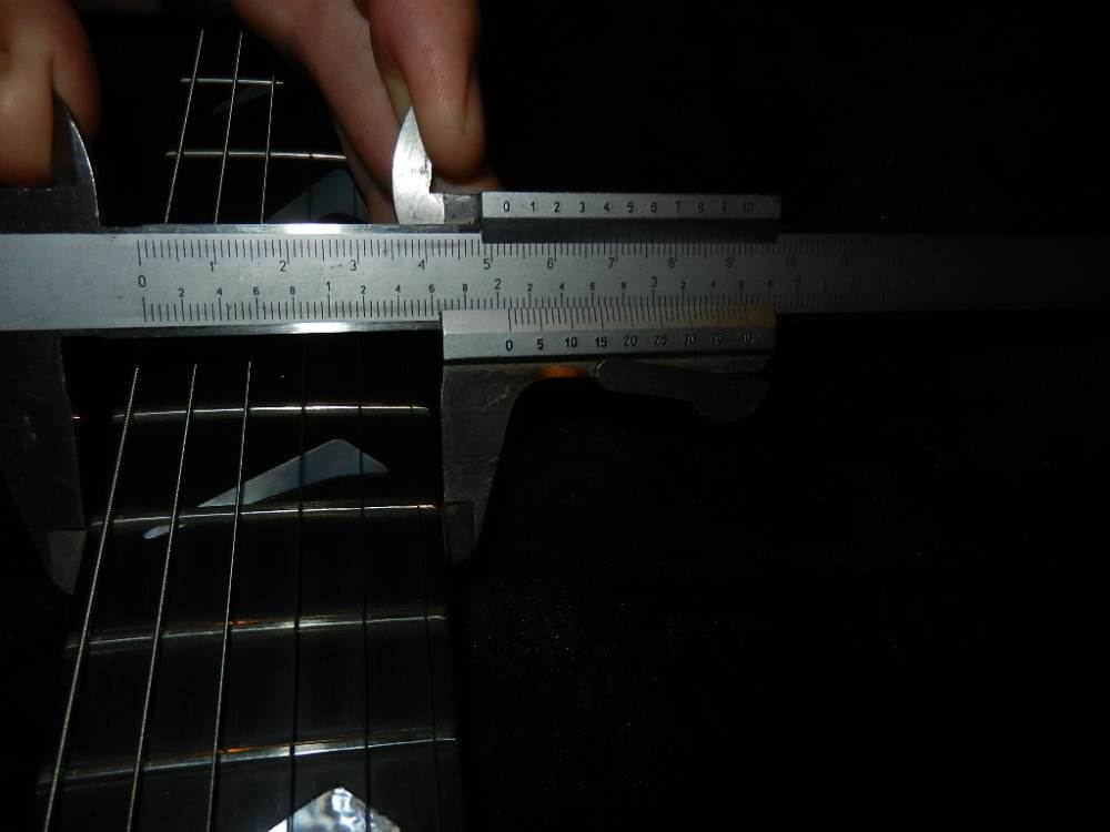

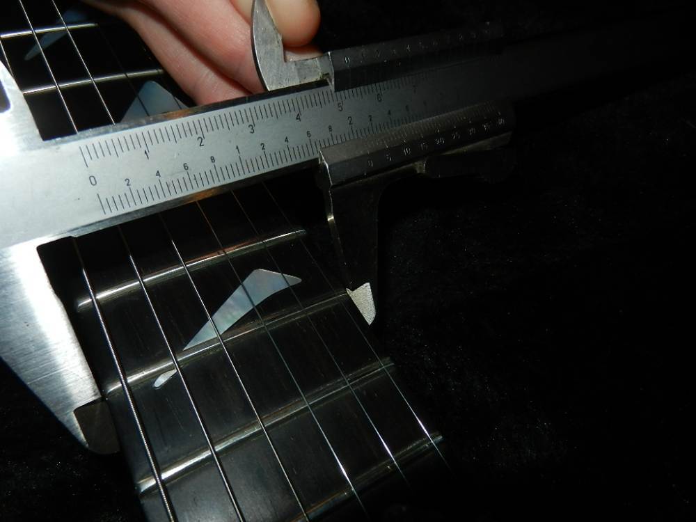

sidvisc1 Posted July 23, 2024 Posted July 23, 2024 Does any one have neck specifications for Hamer Californian Elites? I'm looking for neck measurements at the first and twelfth fret in 100ths of an inch. Thanks so much!
Jimbilly Posted July 23, 2024 Posted July 23, 2024 does this work? you might need to brush up on your Vernier scale reading skills!? This is my '91, the dot neck 89 I have is a tiny bit narrower at fret 1, and effectively the same at 12. (I'm pretty sure this is an Elite, I get mixed up sometimes), I can get more/different photos if you need them.
sidvisc1 Posted July 23, 2024 Author Posted July 23, 2024 Thank you, Jimbilly! This is extremely helpful. If you don't mind, I would be curious to know how deep the necks on your Calis are, too. I have two, and one is substantially more chunky than the other. To the point where I'm thinking of having it shaved down to a slimmer profile. I wonder if they had a standard profile throughout production? Or did it evolve as the years went on? Again, thanks for your help.

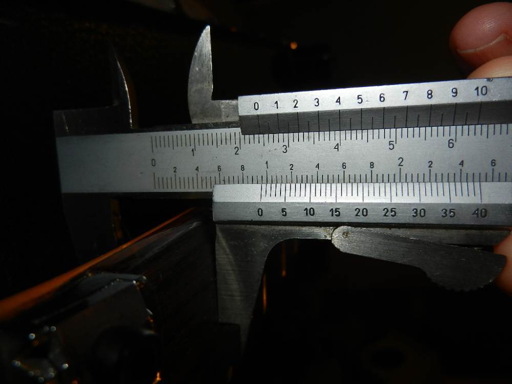

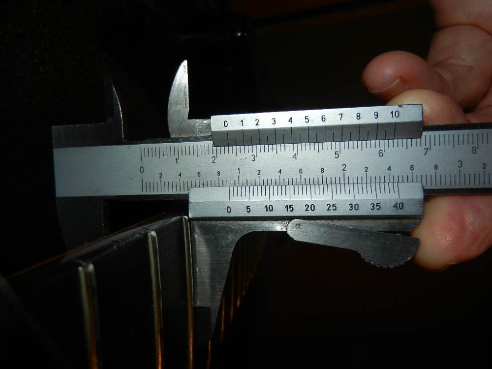

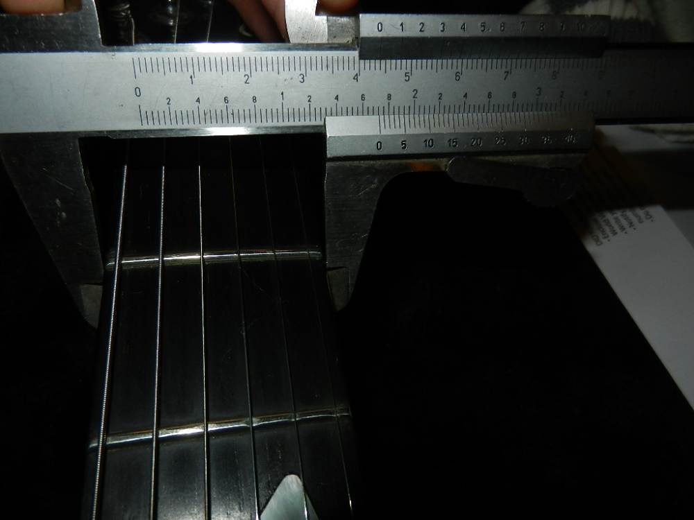

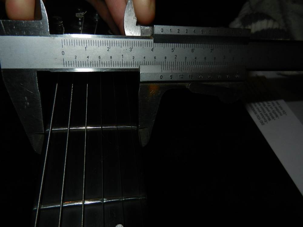

Jimbilly Posted July 23, 2024 Posted July 23, 2024 it's much easier to measure without the strings on!, and my '89 just happens to be de-strung at the moment. It seems to me that the 89 is just a tiny bit thicker than the 91. At 12th fret followed by 1st fret. edited to add: calipers are on the fingerboard, not on the fret.

velorush Posted July 24, 2024 Posted July 24, 2024 Difficult to tell due to perspective, but at any rate all measurements appear to be in excess of 24mm, i.e., in excess of .945." Do you happen to be including the fret in those measurements? That's larger than a 50's Les Paul first fret. Ginormous for a shredder guitar (and right up my alley).
Jimbilly Posted July 24, 2024 Posted July 24, 2024 2 hours ago, velorush said: Difficult to tell due to perspective, but at any rate all measurements appear to be in excess of 24mm, i.e., in excess of .945." Do you happen to be including the fret in those measurements? That's larger than a 50's Les Paul first fret. Ginormous for a shredder guitar (and right up my alley). My calipers are on the fingerboard, not on the fret, - I'm just a bad photographer.
velorush Posted July 24, 2024 Posted July 24, 2024 1 hour ago, Jimbilly said: My calipers are on the fingerboard, not on the fret, - I'm just a bad photographer. Not at all. The photo is extremely clear - the Main Scale in the second photo is clearly indicating 24 mm, or (24 / 25.4 = 0.945") before even getting to extra bits on the Vernier Scale. Could it be the photos somehow posted in the reverse order (first fret, then 12th fret rather than "At 12th fret followed by 1st fret")? That would make more sense as the first photo is showing 23 and change, which is still really a large-for-shredder (23 / 25.4 = ) 0.906." Oh, and love the boomers in the top shots.
Jimbilly Posted July 24, 2024 Posted July 24, 2024 2 hours ago, velorush said: Not at all. The photo is extremely clear - the Main Scale in the second photo is clearly indicating 24 mm, or (24 / 25.4 = 0.945") before even getting to extra bits on the Vernier Scale. Could it be the photos somehow posted in the reverse order (first fret, then 12th fret rather than "At 12th fret followed by 1st fret")? That would make more sense as the first photo is showing 23 and change, which is still really a large-for-shredder (23 / 25.4 = ) 0.906." Oh, and love the boomers in the top shots. I think the 2nd set of photos is correctly labeled 12th followed by 1st, at least how it's being shown on my screen. Either way, the nut or tuners should be visible in the 1st fret photos.
velorush Posted July 25, 2024 Posted July 25, 2024 13 hours ago, Jimbilly said: I think the 2nd set of photos is correctly labeled 12th followed by 1st, at least how it's being shown on my screen. Either way, the nut or tuners should be visible in the 1st fret photos. You are correct. The nut is clearly visible (on closer examination) in the second photo. Larger at the nut than at the 12th fret; another oddity. Very interesting neck.
