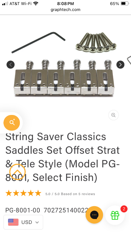

Jimbilly Posted April 23, 2025 Posted April 23, 2025 I recently got a strat with those already installed. OEM block saddles are only around $25. What's your take on graph tech?
RobB Posted April 24, 2025 Posted April 24, 2025 I’ve used them on Strats. After repeated attempts, they don’t stay installed for long. Combined with a properly cut/lubricated nut, they can help a trem stay in tune. To my ear, they impart a bit of a, “sponginess”, to the tone that is not pleasing. If you have a particularly bright Strat you may like the effect. Don’t get me started on the TOM saddles, LOL. Personally, for vintage Strat trems I prefer Highwood saddles. They’re designed with a small string channel and hex screws that don’t dig into the palm. Combined with Gotoh staggered, locking tuners my EJ Strat rarely loses tuning. ETA: I see now that you have an American Std trem. Let us know how you like the stock saddles. IME they’ll be an improvement.
velorush Posted April 28, 2025 Posted April 28, 2025 On 4/24/2025 at 12:28 AM, RobB said: ETA: I see now that you have an American Std trem. Let us know how you like the stock saddles. IME they’ll be an improvement. FWIW: I had great results with the Callaham block for the American Standard trem. It allows for use of their trem arm (no slop). I was also partial to their bent steel saddles, but you may prefer the American Standard saddles.
Jakeboy Posted May 10, 2025 Posted May 10, 2025 I loved the Callaham bent steel saddles much better than the AmStd blocks. Zingier and less string breakage on my Strat. I also tried the Graphtec String Savers. They REALLY eliminated string breakage but they did something to the tone like @RobB said.
RobB Posted May 10, 2025 Posted May 10, 2025 I was referring to the phenolic saddles. I had forgotten that Graphtech makes these with the teflon inserts. I’ve never used them, but they look like a good choice. String-saver saddles.
geoff_hartwell Posted May 16, 2025 Posted May 16, 2025 I love graph tech saddles and they are the first thing to go into my gigging guitars that aren’t Duotones (along with Schaller locking tuners). For tune-o-matic Hamer Artists and LP, and also strats. To me, there is no perceived tonal difference that is not eclipsed by the vast improvement in tuning stability and string breakage.
