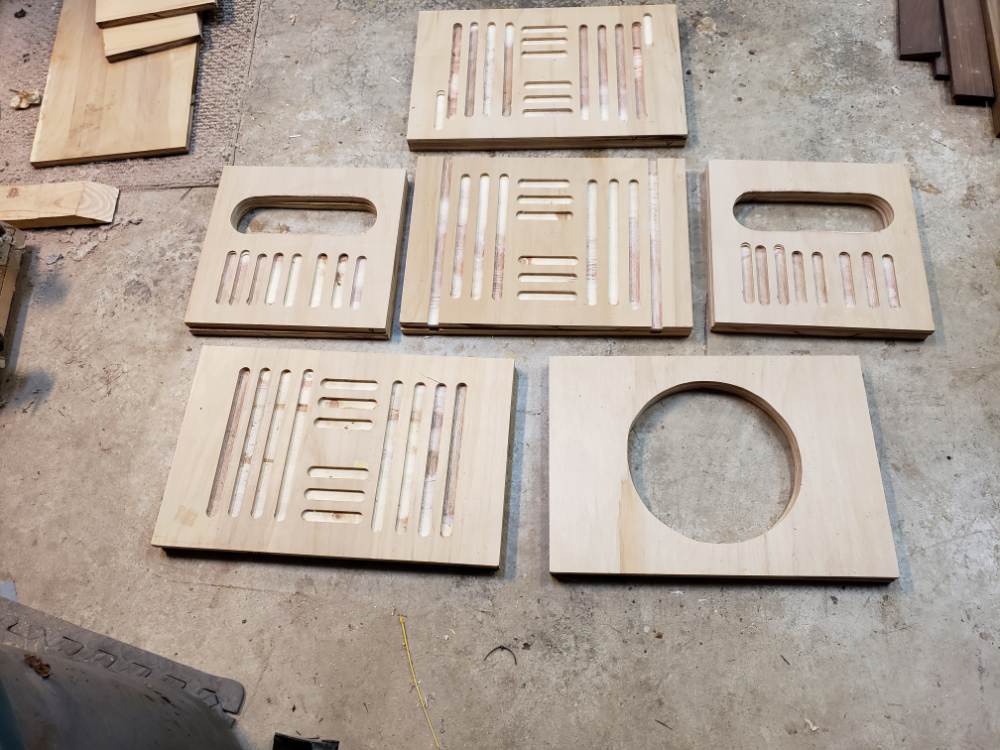

I'd like to make the Forte 1x12 and maybe 2x12 next, but I can't seem to find the plans.. if anyone has a link for these please post
This might help you get started. Finished dimensions are 22 x 16 x 14. Which should let you sort out the pieces......Internal reflecting panels on the sides and optionally on the back can be sorted our later.
While I build 2 x 12s in both vertical and horizontal configurations, I think it is better to build two 1 x 12s and stack them. The 2 x 12 gets heavy real fast, esp if you use my preferred combo (Alnico Cream up, EVM down). And it is not exactly small. But it looks great!
But when I did build the 2 x 12, I essentially used a single center divider, making the two speakers individual/independent. And that helps if you want to do such as a Plug and Play panel to enable mono or stereo.
Update, I installed the fiberglass per the plans, and it definitely sounds better, more rounded, more punchy, less internal reflectivity, I could hear it before.. definitely recommended
